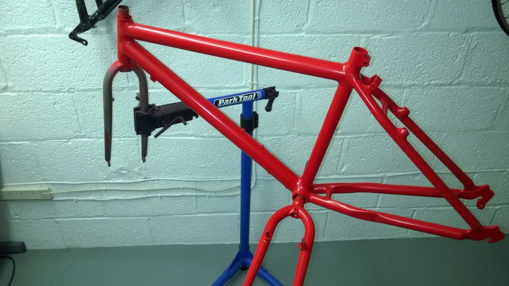

Here you go, a way to go yet before its done, sorry I have no decent camera :(

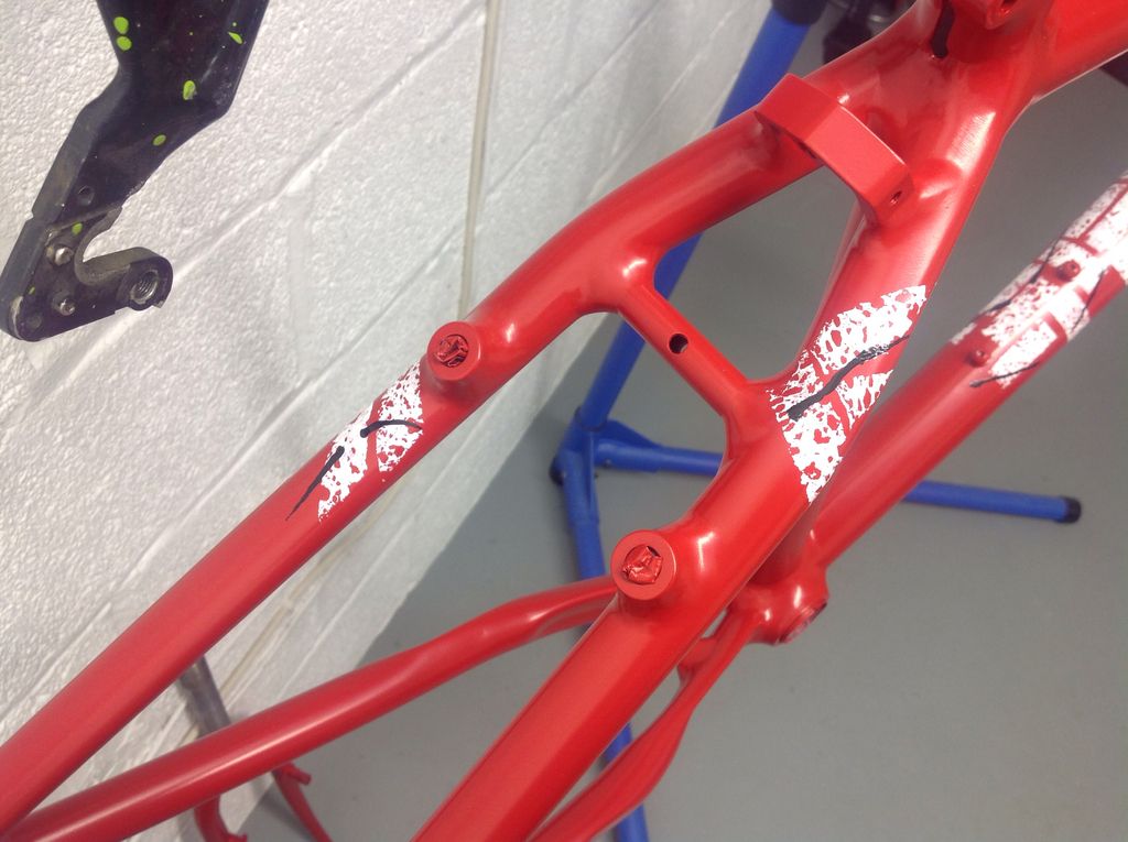

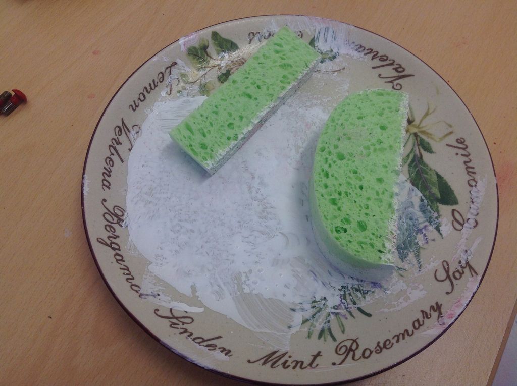

Had a few hours to spare today, so went to Tesco and selected a suitable sponge £1, here are some progress pics 8)
Cut out my tracing and stuck to frame and started sponging!
If I get time tomorrow I will clear coat :D
How it was at the start...
