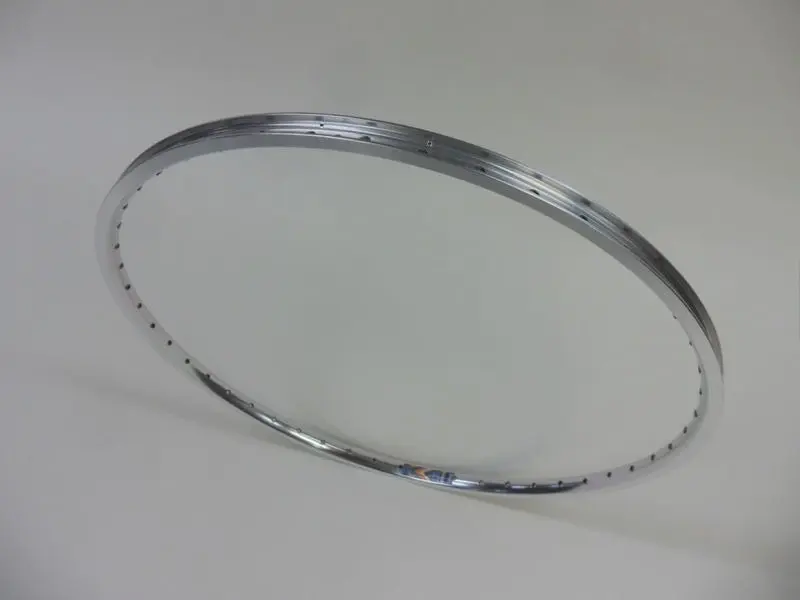

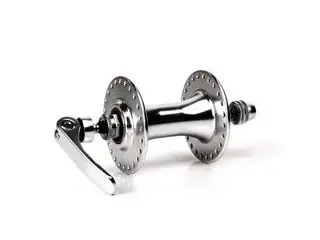

All change on the wheel front.
I called the guys at JD Tandems in North Yorkshire initially to order some tandem spokes (2.3mm at the J end) but then got chatting about my wheelless project and the touring rims I have. After admitting the frames weight, my weight and Jimmy's they convinced me to have a set made up by them, especially if we wanted to carry kit on a tour!
So 48h front and back using Sapim spokes with Orbit tandem hubs on Kinlin rims.

Wheels built, with a set of Halfords own brand sealant filled tubes inside some fancy white walled 35mm Michelin World Tour summer tyres.
probably get some 38mm Schwalbe Marathons for the winter 82B82D08-8BE7-41A7-B520-0916365AE0A3.webp

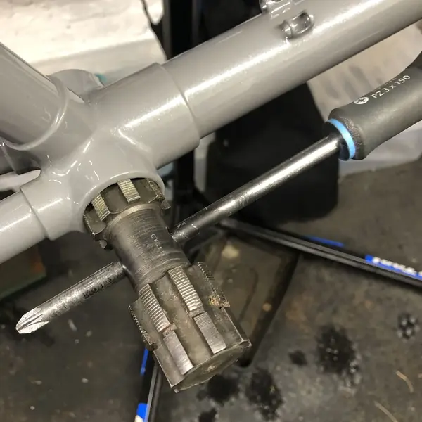

Got the frame back from the powder coaters, turns out the metallic flake aluminium grey looks absolutely nothing like the RAL code swatch. Not sure yet if I like it. It does look better in the sunshine but it’s more like one of those modern glossed over primer greys you see on Landrovers or BMW’s. I think I’ll build it up and see if I get used to it..
so first job is to squirt silicone spray into all the tubes to help prevent any new surface rust appearing, re-cut all the threads and using a drill with a home made long emery cloth flappy device polish the inside of the seat tubes. 2E93140F-3493-4B6D-94BD-372EDD15AC2B.jpeg
