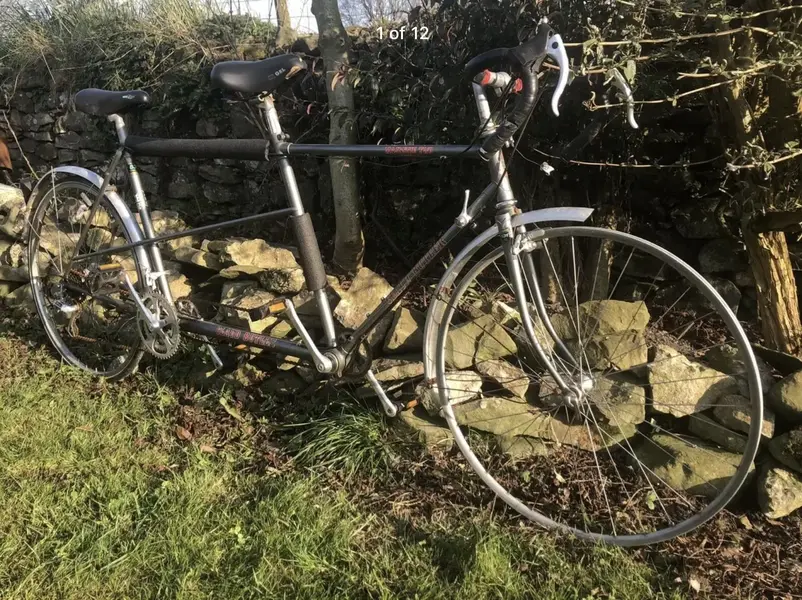

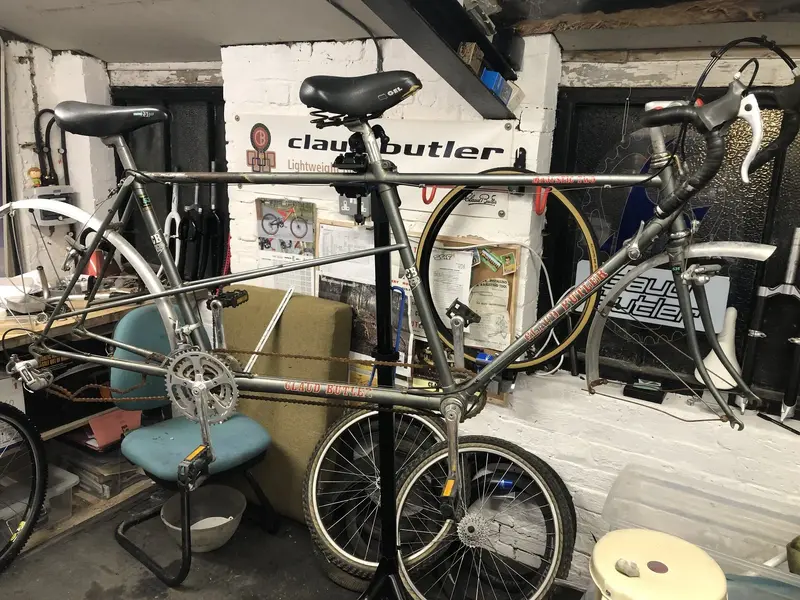

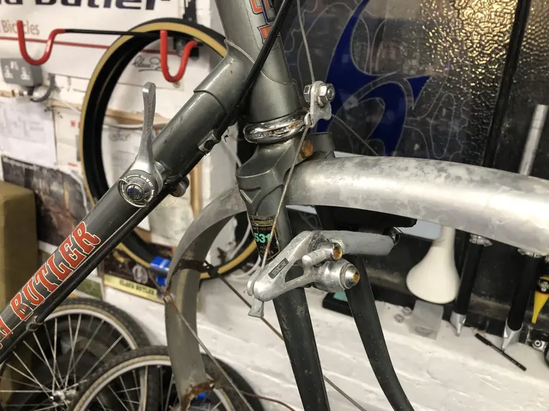

Right, given up (for now) on getting a Jack Taylor Tandem as all the ones our size (me & our Jimmy) are all pretty pricey. So I thought we might start out with something a bit cheaper.
The Marlboro groups version of the Majestic Tandem available in 1987, was the first Majestic Tandem to have Shimano indexed gears. It also has 700c wheels, giving me more scope for tyres.
I thought this might make a good platform for something that might be also able to run along quite happily on a gravel path/tow path/green lane as well as road.
This one has the Deore mechs swapped out for DX, and the owner believes they were original so maybe this one got built up a little later? Maybe late ‘89 or early ‘90?
Anyway, first question as this bike doesn’t have any wheels is; if I build up a set of 36h 700c Wolbers on some DX MTB hubs with straight spokes, will this be tough enough?
PS I’ve got a set of Specialized 700c suspension road forks I thought I’d use, just to smooth out the bumps. 47CEA12A-E136-4F89-BCAA-87BA60144C1D.jpeg8C92F720-F040-42F9-810D-AF05FDCDB98A.jpeg

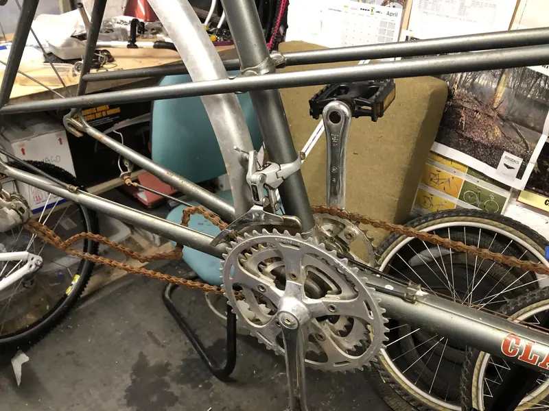

Well it’s home...

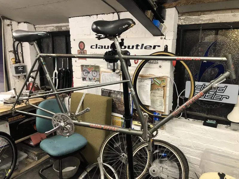

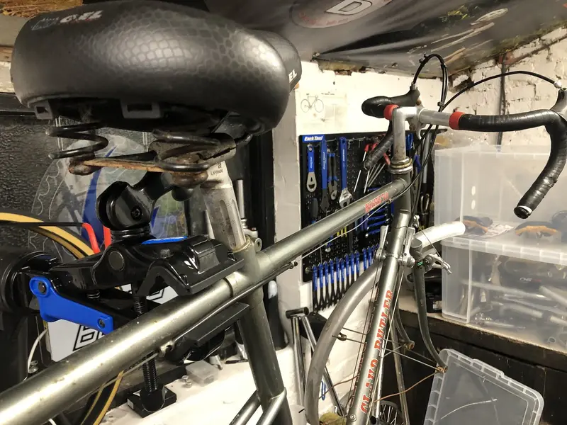

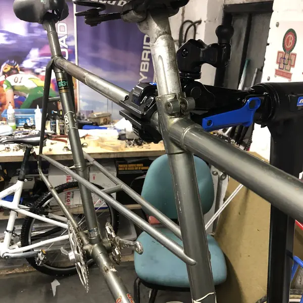

Strip down came to a stop with stuck seatposts (both) and stuck crank bolts dust covers. All have been treated to a liberal application of GT85. Will have a crack tomorrow. Fingers crossed all goes well as I want to drop it off for a strip a powder coat ASAP. E101BE5D-EE60-4B6A-8BDC-8CAB799F12A0.jpeg9AA2EC40-40E4-4CCE-A639-90F217D8EA57.jpegEC837F26-718B-4CAC-9F23-AC48C5B4C193.jpeg0FB623A2-0101-4D44-878D-082607524BC9.jpegE382111E-87B2-40CD-957E-7D752B71ED5B.jpeg02586669-62A8-4E8C-A9F1-FFFA068DECF0.jpeg07031DF4-1119-4728-B5E5-44A302F037F0.jpeg5DA38E68-2F97-4EBD-9425-E947CC27FD5A.jpeg

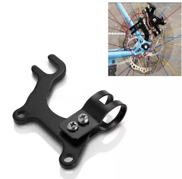

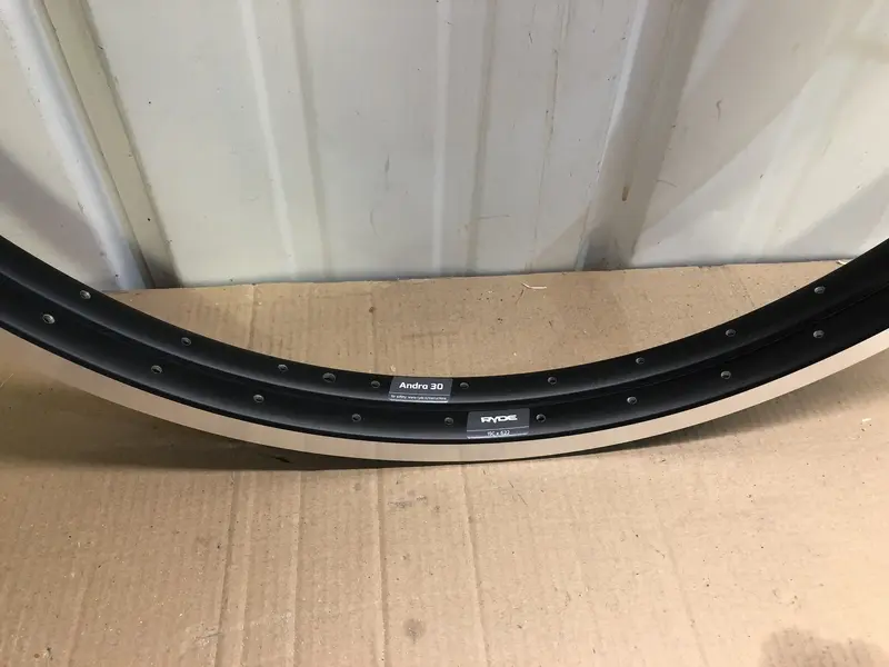

Now then.. it’s 1:45am and I’m thinking about brakes. With this frame having canti studs I was planning on using Magura hydraulic rim brakes with double boosters. But as I’m building the wheels from scratch do I add one of those clamp on rear disc brake mounts so that the rear has an extra “anchor” with a disc brake hub?
And I’m thinking this could be operated by the stoker as I can’t double up the hydraulics in one lever as would be possible if I was using cables. Good? Bad? Pointless? Opinions anyone?

Messy, and not needed in my opinion.
I think you might be right... the Ryde Andra 30 super tough rims have arrived and they have a stonking great 15mm brake surface! So plenty for some upgraded Maggies to get a hold off. F1CF437E-34C3-44D8-92C3-0D5306A1E13D.jpeg

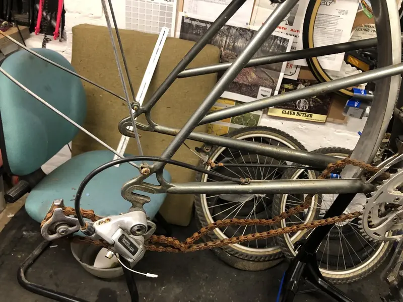

Also I’m thinking of removing the rear drum brake series of braze-ons, I’ve got no use for them and there are quite a lot to just have hanging there empty. 0FA72E99-7030-445E-9BF0-5CEA9BF894EA.jpeg6C63D14A-C2EE-4207-886B-848E51896096.jpeg243F547E-096F-43B6-9207-208DFFB399D0.jpeg
