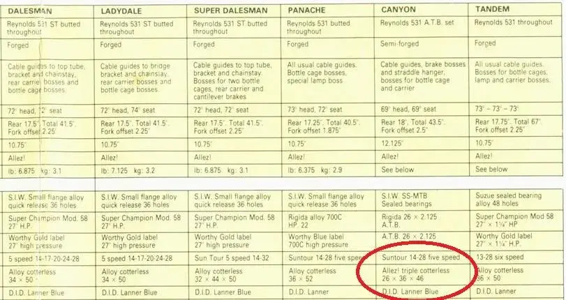

Just in case anyone was wondering what that ^^^^ was all about….. :roll: here’s a brief explanation;
From the late 70’s and through to their demise in 1985, Holdsworth used D.I.D. lanner ½” x 1/32 chains on all their touring bikes, sometimes the ‘blue’ sometimes the ‘gold’ or even the ‘chrome’. (That’s on hundreds of thousands of bikes BTW)
These were initially matched to Italian 5 speed Regina freewheels, and then about 81/82 this got changed to the then popular Suntour freewheels (mainly the “perfect” model) if any of you ever had an 80’s touring Holdsworth or Claud Butler you would most likely have ridden with this combo or at the very least removed one and thrown it away. In 1984/85 Claud Butler used the very same combo on their first ATB the Canyon.
Now, could I fit a better near period correct Shimano with a better chain? Yes, but what for? It would just make me “twitch” every time I looked at it. :?
The D.I.D. chain might not be the best and of course it’s been superseded. But that does not make it “unsuitable” for this build and of course will fit the Suntour 5 speed ‘Perfect’ freewheel that I currently have soaking in an oil bath waiting for my magic touch like a glove :cool: .
Anyway.. best get on with cleaning this lot….. ;)
