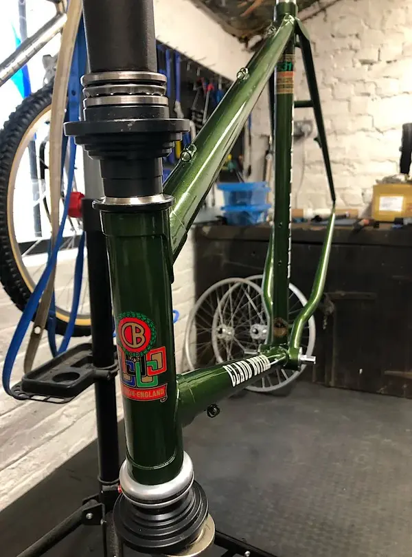

Well as everything else is on hold, I suppose I’d better get on with this...... :cool: A1B03DD2-6A5B-457D-A948-287376981D8D.webp

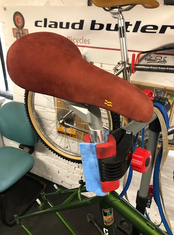

:D Seat post in, saddle on.... time for a brew I think.... ED0FDEB4-30B4-478A-8EE3-8C5673F93410.webp

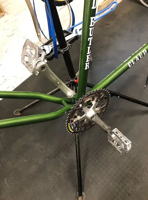

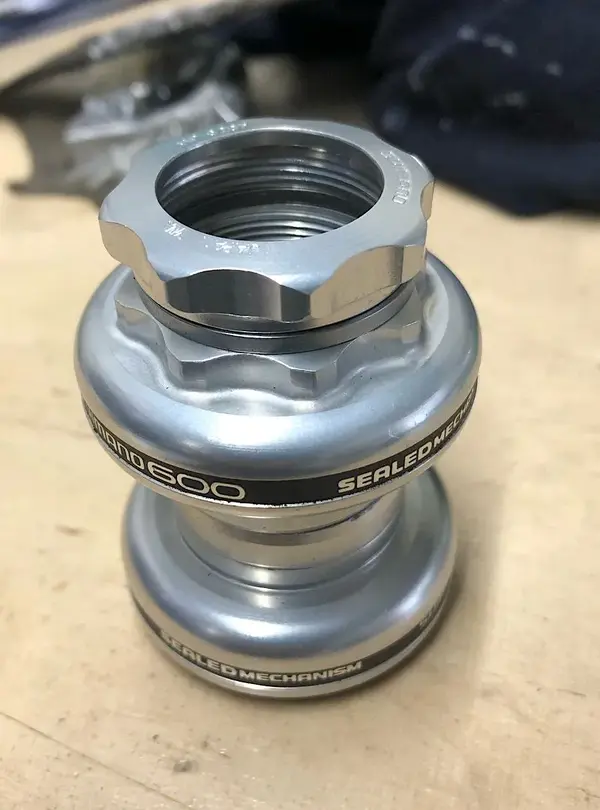

Beautiful 600 headset went in perfectly, but then a few things needed sorting, I didn’t realise that that the Nitto bars had developed some surface rust on the welds, so that needed sorting, then a slight panic ensued as the left crank didn’t clear the near side stay :shock:
But the chainring arm has loads of clearance, so a quick flip of the axle so that the short side of the axle was used for the drive side, everything now clears perfectly (well 3mm either side)
