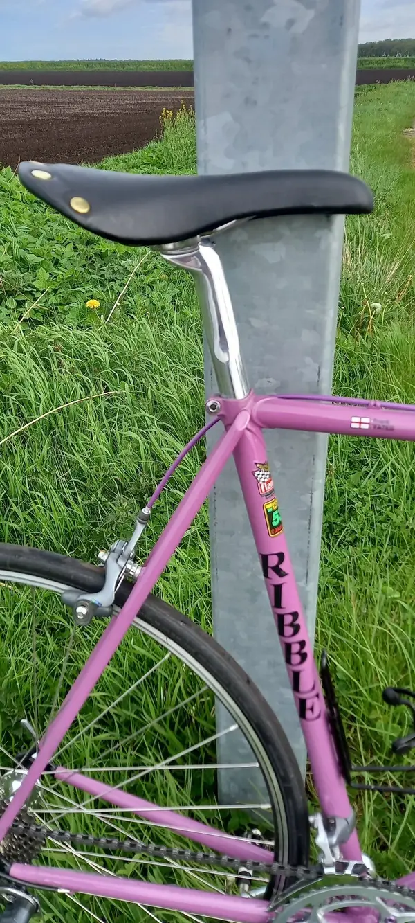

Having admitted to myself that my Ribble winter bike was really too small, but wanting to keep the modern 105 groupset and other parts, I figured I'd attempt my first restomod. Eventually I found a Holdsworth locally for the frame donor, which seemed to fit the bill. It turned out to be the epitome of a parts bin build, with mismatched wheels, brakes, and cranks - plus a weird arrangement with MTB shifters on the middle of the bars. Good thing it was going to be stripped down, I suppose. The frame also had the wrong decals, and a home printed 531 decal which was about 4 times bigger than it should be.

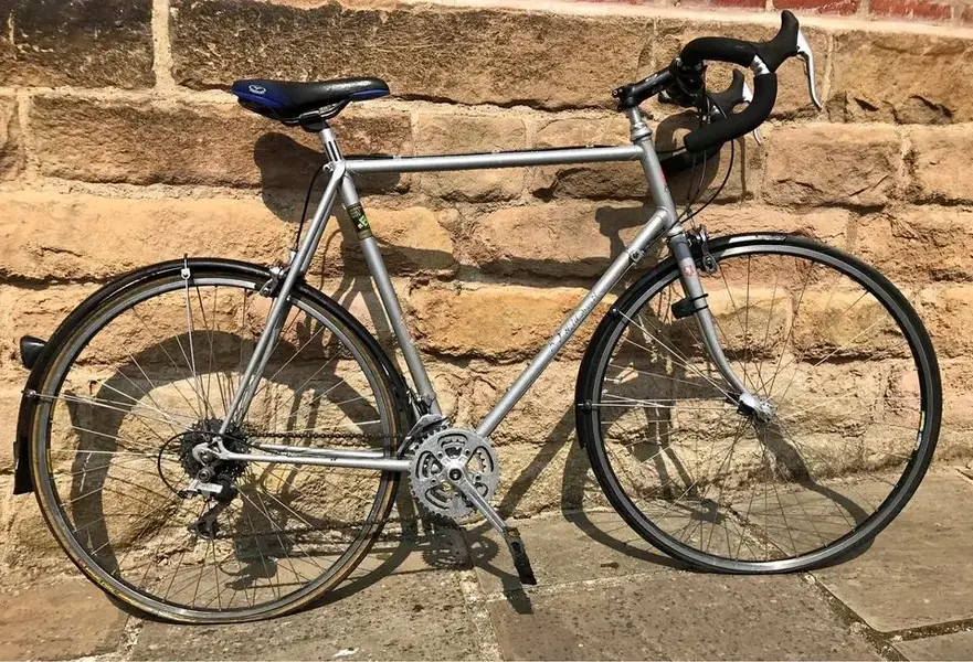

This is how it looked:

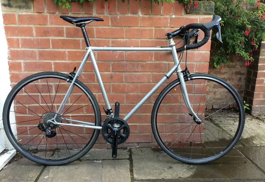

After a strip-down, this is how it looks with the parts swapped over, plus the headset and quill adapter that came with the bike (at some point I will probably use a quill stem instead when I source a black one plus new bars) – obviously it's not properly cabled up yet – I need to get some new outer cables first. I also need to add the mudguards to check the clearances with the brakes.

Anyway I've fully built the bike up now – only a few small adaptations needed to fit the modern stuff, plus the usual frame spreading which seems to have gone fine, as everything shifts rather nicely with only minor tweaks to the RD limits needed.

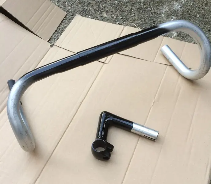

No progress on the frame yet – hopefully next week I can drop it off, but I have decided on a quill stem and new bars rather than the ugly ones that came with the Ribble. They need to be black to match the groupset, so I've done a bit of spraying. I already had some nice Cinelli bars which were too scratched up to look good as they were, so those were a good starting point. I bought a matching Cinelli stem which also had a few marks so that's had a spray too. Two coats of primer and two of paint seem to have done the trick.
