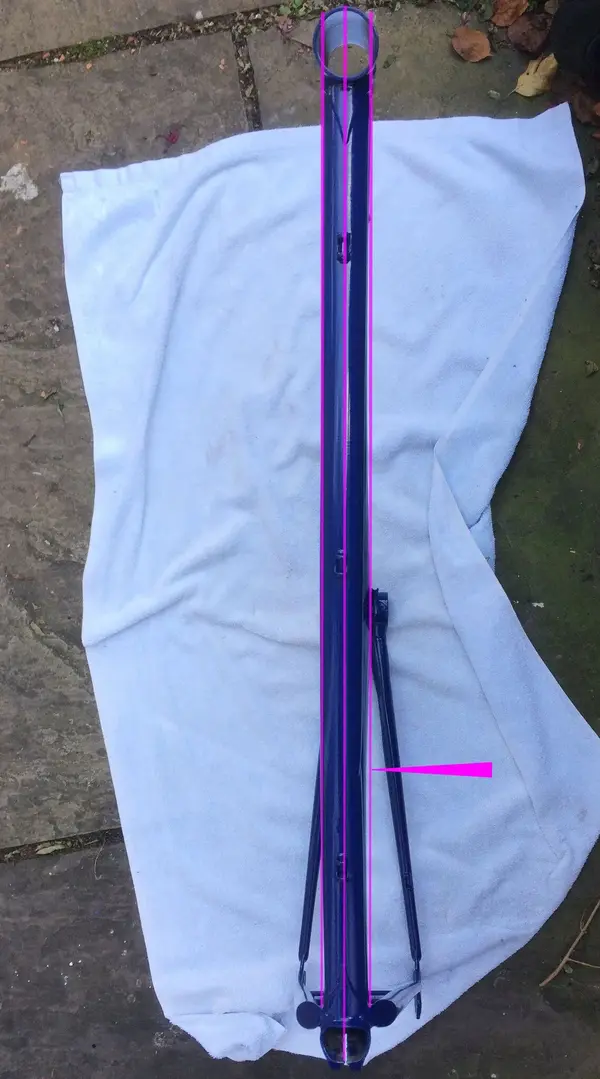

Well. The good news is that I've got a frame that has been powdercoated fairly well. The bad news is that somehow they managed to properly dent and bend the top tube 🤬. Obviously they didn't charge me, and luckily the frame didn't cost much at all BUT I would like to keep it if possible. The local frame builder reckons it'll cost up to £100-150 to straighten, at which point I have a frame that needs another repaint, which doesn't exactly sound ideal.
This photo shows where the dent is - it's not easy to show the extent of the bend, but it's most obvious on the right where it bends inwards. Both ends of the tube are not actually that far off each other in alignment, so I'm wondering if this is ridable as it is? Is that a stupid idea? Structurally I think it's fine, but will it handle weirdly? I'll post this question in another thread, probably to get as many opinions as possible.

out of interest what level of repair were they talking about for that price?
a jig and a bit of setting would see it straight but with a dent in the tube, it would at least be ridable.
The frame builder didn't seem to think it could be set cold, so £100 plus is because he'd be heating the tubes. Do you think straightening a bend like that can be done cold?
No way I could say without frame in hand. If he says no, I'd agree with him without evidence to the contrary.
