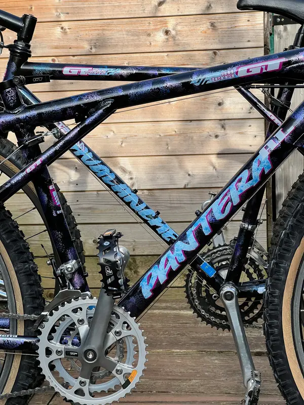

One of my favourite builds over the last year was @Bart_75 re-imagining a GT Avalanche into Tequila Sunrise 2.0
Tequila Sunrise 2.0

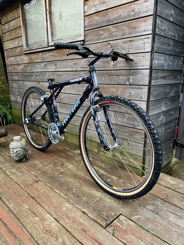

Shortly afterwards, I was lucky enough to get my hands on a (rather neglected) 1991 GT Team Avalanche Midnight Aurora which I restored. While I was researching this bike, I saw a few photos of GT Pantera with the Midnight Aurora paintwork. From what I could glean, this was a special order paintwork from GT and no-one quite knows how many were made.....but not many... a handful perhaps.

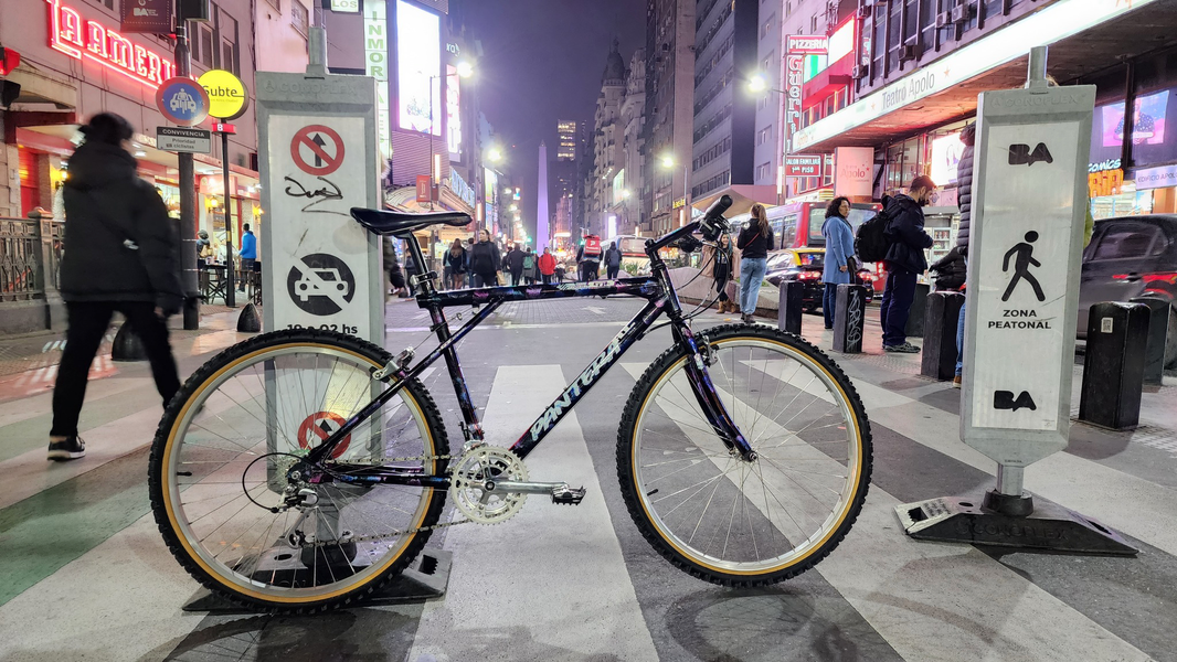

I remember thinking how cool it would be to find one. @Bicisdelos90 in Argentina has one Pantera
![384127979_6935323206514892_157922114498563147_n.jpeg 384127979_6935323206514892_157922114498563147_n.jpeg](https://www.retrobike.co.uk/data/attachments/678/678589-607a5f75d107afdb12cddb33402b2e23.jpg)
But the likelihood of finding one was pretty low... So I thought I would follow Bart's idea and create my own...well have a go anyway...

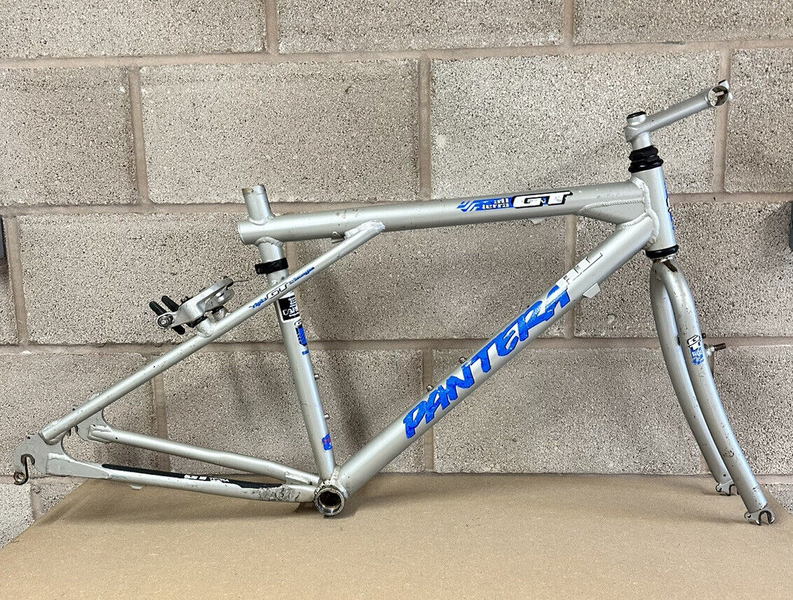

First thing to do was buy a Pantera frame. I found one on eBay. In retrospect, it probably would have been easier to buy a complete bike... but I bought a frames for not very much.
(Amongst GT's, it seems that Panteras don't get a lot of love... always in the shadow of their more successful big brother Zaskar... I do think that they are underrated)
![s-l1600.jpeg s-l1600.jpeg](https://www.retrobike.co.uk/data/attachments/678/678590-f2255fb7ba9efc17cd567890b9217749.jpg)
Well-used, but complete and with a U-brake and seat-tube cable thingy. I gave it a clean-up and left it the shed for months whilst I worked on other projects...

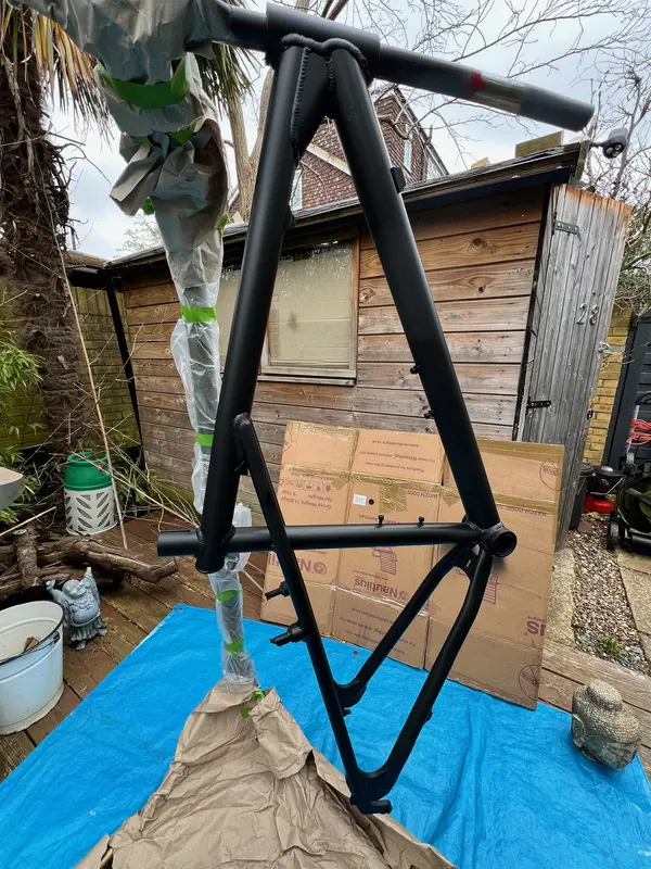

Once that had dried, it was time for the base coat. Black. I used spray.bike paint. 3 coats.
![IMG_3727.jpeg IMG_3727.jpeg](https://www.retrobike.co.uk/data/attachments/678/678596-094d8189abc94a16c4a23d7f5666e627.jpg)

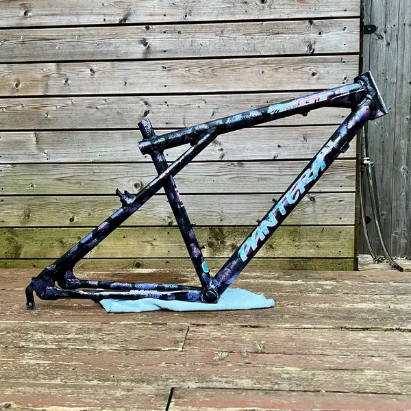

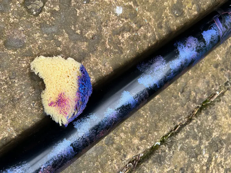

Next I needed to apply the Aurora's.
I used Acrylic Metallic paint and a Sponge (Real Sponge by Seawhite of Brighton) and experimented on a piece of black guttering to get the right paint load and application method to match the pattern as closely as I could.
I'll admit I was anxious about starting it and f**king it up...but then I thought it's just an old Pantera frame, 'who cares?' and got on with it... it was actually quite enjoyable/
![IMG_3750.jpeg IMG_3750.jpeg](https://www.retrobike.co.uk/data/attachments/678/678597-fececbdf762269fd25eba07c55200ffc.jpg)
Once the Aurora's had dried I applied the decals. For the first time ever, I almost messed this up.. but salvaged it..

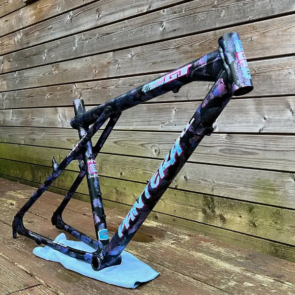

Final stage was to clear coat it. I use SprayMax 2K, three coats.
The clear coat was done yesterday morning. right now it is drying/hardening for a week or two before I build the bike up...
