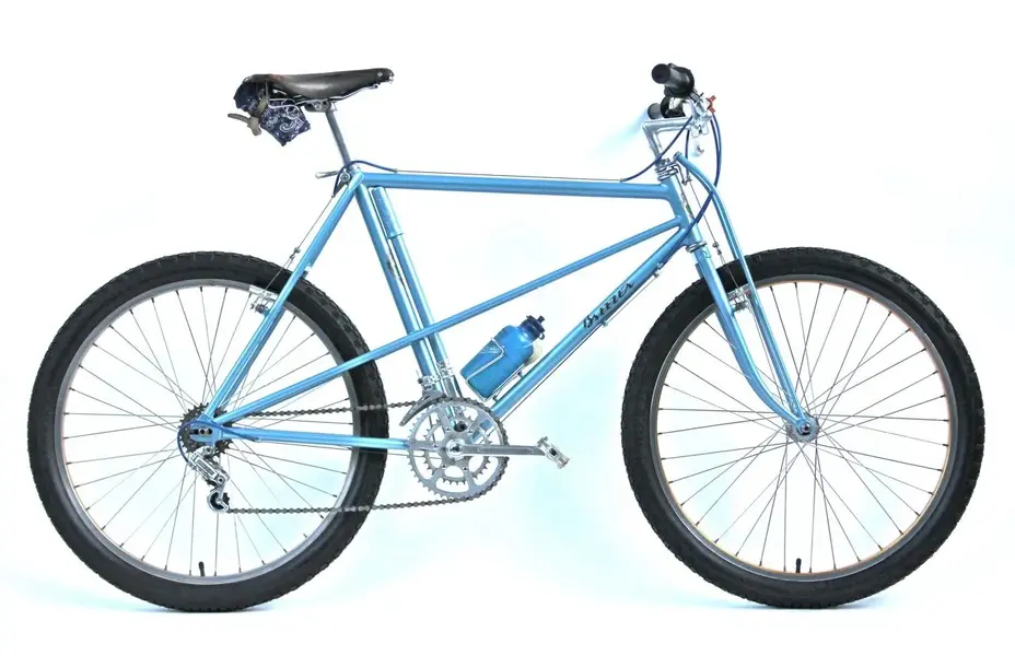

Okay, so maybe you're wondering why this skinny bike appears on an MTB chat page. Basically, I needed a place to park a photo so it can be linked from another site. BUT there is MTB relevance:
Otis Guy and I commissioned Tom Ritchey to build us a tandem for our cross-country (SF-NY) record attempt. Early in 1979, I showed my Breezer #1 MTB to Tom. Specifically I wanted Tom to join the two sets of twin laterals to the seat tubes on our tandem-to-be the same way I had joined them on my Breezer, with an elliptisized cross tube.
Breezer #1 was the first such balloon-tire bike Tom had ever seen and his ample mental machinery went spinnin. I hooked him up with Gary Fisher and, well, you know the rest.
Tom Ritchey was inducted into the US Bicycling Hall of Fame November 2012, and our tandem has been there since.
UPDATE: Both our Ritchey tandem and Tom Ritchey's first mountain bike are on display at Marin Museum of Bicycling in Fairfax, California.
Joe

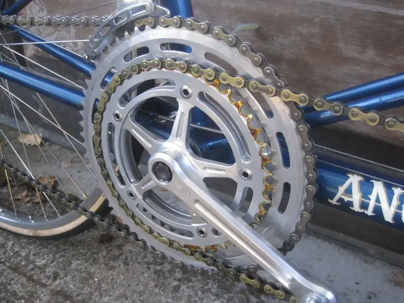

How did the all right side drivetrain work out back then? I know a couple of people who can't get it to work reliably with current equipment.
phill77":4xor7eao said:
That looks like some serious gearing!
That is a 62T Sugino Mighty. We had a 13 in the back (12 or fewer wee very rare in 1979, but couldn't cut it on a speed tandem back then). Our top gear was almost 130 inches. On Interstate 80 crossing Wyoming we passed a car while we were in the fast lane. Okay, we had a good tailwind, but it was flat, almost. :)
Regarding the chain configuration, see my attached photo. The trick is to space out the primary chainring enough so the final chain NEVER touches the primary, while at the same time the primary ring stil has a footing on the crank spider's outboard ledge.
I used washers about 1/16" (1.6mm) thick. They should be good quality flat washers with square edges. Nothing puffy from a hardware store. I surface ground ours for best results. The washers will likely be a bit large in diameter, but just truncate to fit above the ledge.
I beveled the inside of the 62T ring on a lathe. The bevel is similar to the one you can see on the outside edge (which needn't be there). The bevel is not needed with normal size rings. It's so the chain from the small (47T) ring doesn't 'ting' while passing to the smaller cogs.
We initially tried this "right-right" chain configuration, sans washers, with near disastrous results. Amazing how quickly a crossed chain pin can bring four churning feet (while honking out of the saddle!) to a complete stop. Don't try it.
I first saw the "right-right" set up on Bruce Gordon's Bob Jackson. For primary tensioning, he used a chainring slipped inside the chain run midway between the cranks. Elegant.
