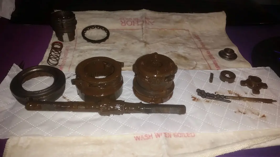

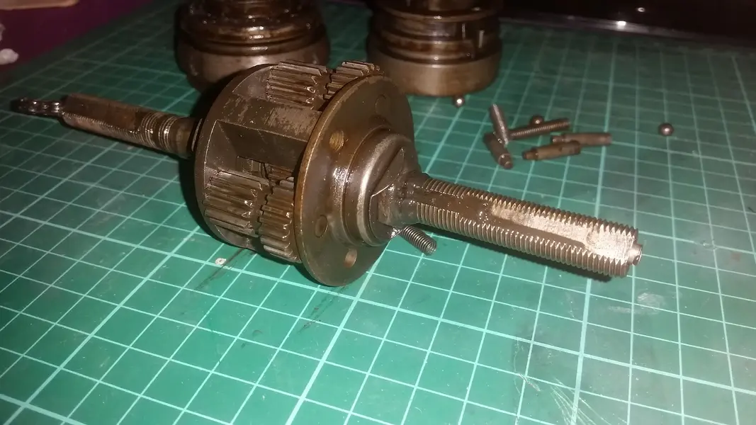

Thought i might as well add this.. a comparison between the grease hub (25 years old) and the Oil Hub (60 years old) the grease hub showed quite a lot more corrosion than the oil one and the grease did not look too clever it went brown and horrible. despite the 60 year old oil hub being kinda neglected for quite a few years and then left out in the rain for 1 or 2 when i took it apart that was how it looked
So regular light oiling would be much better than leaving it in grease for long periods of time. (though i guess you guys know this much already)
Cleaned up the parts... left the dynamo alone and greased the axle bearings. The ball cup bearings I'll have to do later but I put it back together and it works fine. Further increasing my love for older tech.. it's sturdy. doesn't change the fact that the gear adjustment is finicky

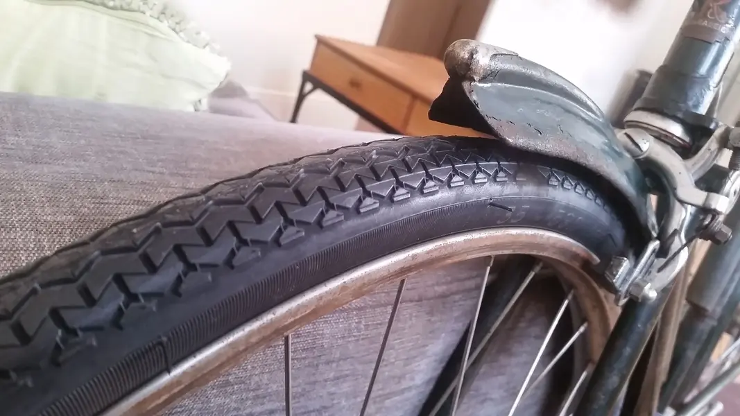

Hey guys thought i would update since i havent in a while.
I got a new R.I Prop stand which is in much better condition.
DIY'd the bottom plate for the FSU battery housing
Put new tires and dunlop inner tubes on.
Theres still alot to do however
I have now ordered original front brake cable and replacement Chaincase parts
