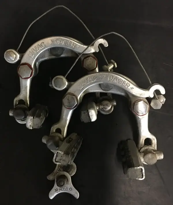

But recently in my request for anyone who might want to part with a pair of Mafac “Racer” centre pull brakes, I inadvertently entered into a swap, with allenh.
He had some Racers, and wanted some period quality levers, I offered up a pair of GB Arret’s that were surplus to my requirements and the swap was arranged. A few days latter and I have a tidy pair of Racers….. time to start polishing!

They are great brakes and they come up looking really very nice. I was given a set for my Jack Taylor and after a bit of polish and a £ or so for some new red bushes sent from France and they work a treat. They didn't need new bushs/sleeves but I just liked the look of the red.
Started with these:

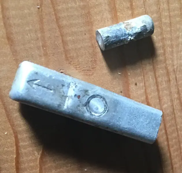

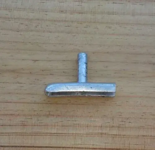

Yes… oops indeed, it looks like one of the washers on this block may have been Stainless Steel rather than zinc, so its suffered a little from some bimetallic corrosion. The other three just twisted apart really easily, but the fourth was more stubborn. And with an over enthusiastic twist I snapped it clean off! A couple of taps with a punch and the shaft popped free, (should have done that first time around)
Remember kids, zinc & aluminium are right next door to each other at the Anode end of the table so are much happier bedfellows when wet.
Stainless leans more towards the Cathode end so can get a bit messy over time when sat with aluminium.

There's nothing worse than that sudden easing up when twisting something corroded, its the millisecond of oh that good it's freed up before the realisation of no it hasn't it's snapped kicks in.
