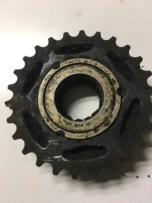

I've been looking for a French freewheel ...obviously, but all the 60's stuff I had found so far have the French thread (1.366" x 25.4TPI), not good on either British/ISO/or Italian 24TPI. So I had a scan of French freewheels on Velobase, looking for an ISO one from the 70's.
I've never really looked at French units before, only checking to see if a freewheel is a Regina or not, if not, they’ve gone in the "mucky box". But as I scanned the Maillard cogs I started to recognise various details of the Maillard Normandy freewheels. They have the "Made in France" stamped on the 5th gear/cog as there is no face of the freewheel to mount it on. I'd not spotted this before as my "mucky box" stuff has not been cleaned... so I rushed out to the workshop and after a quick scrap of some muck, hey presto the magic tome "Maillard - Made in France" and on the reverse 1.375x24tpi ISO...
Danseur!

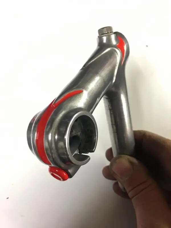

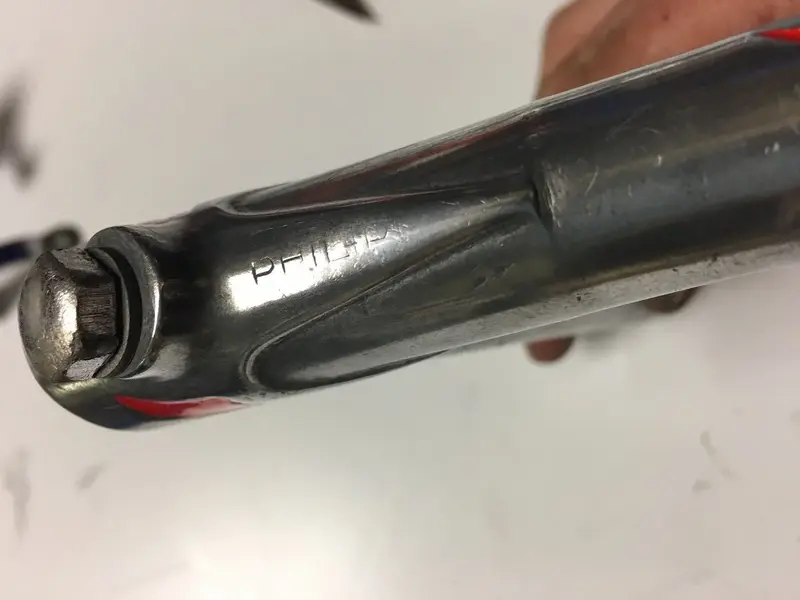

So tonight, I was mainly colouring in….. :lol:

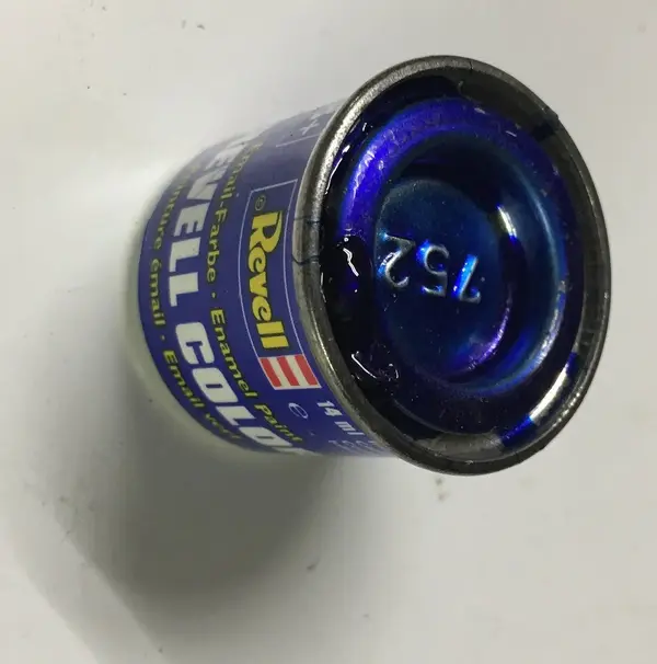

The painted parts are looking really smart!
What paints are you using? The red looks like a standard Humbrol type enamel but the blue has a metallic look to it.
Re: Re:
Both old school Humbrol enamel, not the modern water based low voc acrylic rubbish.
The red is a solid colour to cover aluminium and is a good match for what was originally on the stem. But for the chrome I have used a Humbrol Clear colour or I think it was called "glass paint” (basically a coloured lacquer) I'll add the reference number later.
I find this always looks great on top of chrome. I tried a red, but it was too cherry like and as the only chrome I wanted to use it on was the cranks I thought I could get away with the solid red rather than having two types.

My mistake, its not Humbrol but Revell colour 752
The guys at e-models have a very good range https://www.emodels.co.uk/paints
