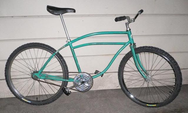

P.S. For grins, here's my coffee shop klunker to hold me over until I get the Fleet done.
It's a 1959 or 1960 Rollfast Space Racer (free after selling the rack, chainguard and fenders on craigslist)
VP Pedals, Kalloy handlebar, and Uni Beam seat post from ebay.
Old Ritchey Logic saddle from the basement
Panaracer 1.9 Duster tires from Michigan Mountain Bike Association classifieds.

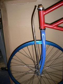

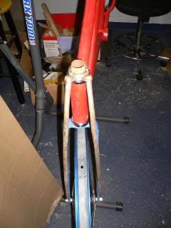

- Fit the BB, fork and truss rods to make sure everything fits
Fitted up the truss rods tonight... a little bending and grinding and they appear like they'll work with the post war fork.

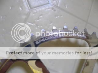

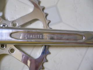

I couldn't resist a set of TA cranks. They are contemporary (newer) and 170mm.
My latest thought is to put a 36T ring on these with retro stickers on the crank arms and make a Michigan style, single-speed klunker -- 36/18. No Mt. Tam's in Michigan for downhilling! :lol:

I also just ordered the 36T TA chainring
