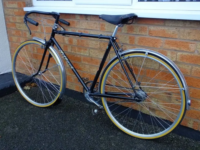

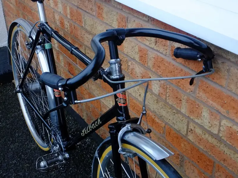

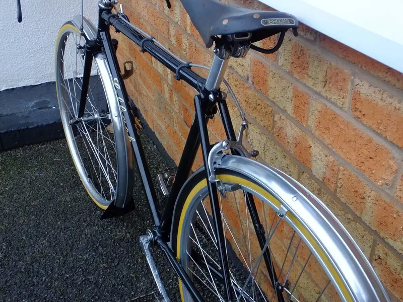

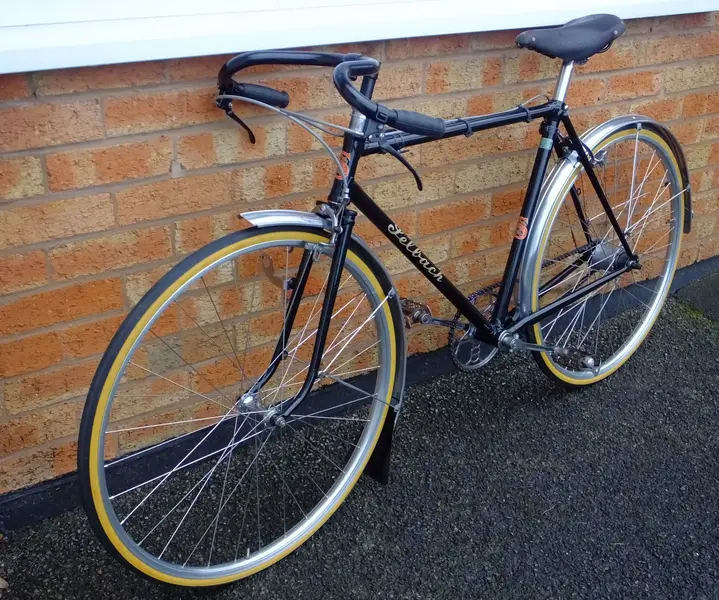

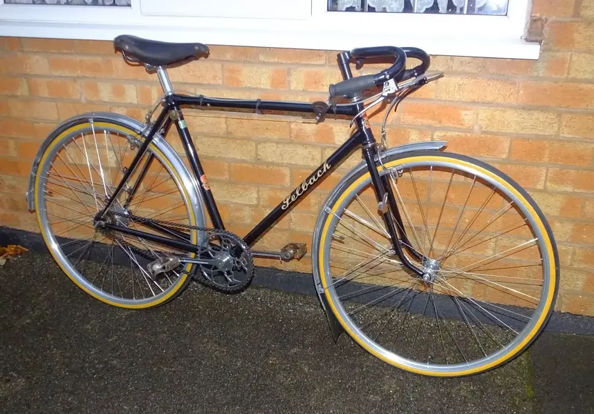

Hi again, just an update on the final version of my Selbach rebuild.
BSA chainset refitted, the cranks were too long on the Williams one.
BSA centrepulls changed for Monitor Climax side pulls - these actually work as opposed to the BSA brakes that were awful.
Tyres replaced with some 650A-28 amber walls.
Grips changed for a pair of nice vintage ones.
Bantel alloy mudguards fiitted.
I'm happy with this now and riding it really does put a smile on my face!

A fab rebuild. Glad you were willing to adopt one or two compromises to make this lovely old thing rideable. Well done!
