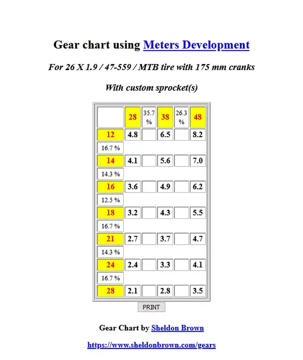

MT, your set-up according to St. Sheldon gear calculator if I understood your post.
The numbers you've entered in yellow fields are correct. Thank you Woz. I'm not sure where the other numbers are from, or where the percentages fit in. For that matter, I'm not certain what Meters Development is either. Sorry for my ignorance.
As you see, a shift in to a bigger (or smaller) ring is about the equiv. of a 3 sprocket shift.
Your mid gear is 38x18 which gives about a 4.3 meters development; fairly normal for flat cruising.
You will notice that if you are on the 48, and go from the 14 to the 12 sprocket there is a massive
1.2m meter development jump. Compare that to only a 30cm decrease when on the granny 28
ring going from the 24 to the 28. That is nothing on steep hill.

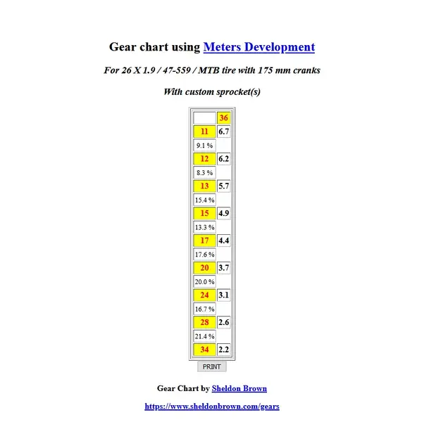

A more sensible approach is to have a linear meters development, or better closer ratios in the
high gears and wider ratios in the lower. Below is a 1 x 9 alternate set-up quickly done to demonstrate
the point. With one 36T chain-ring up front, you will loose only 10cm on the lowest gear, and in the highest
your last 12 sprocket compared to your current set-up. The more linear meters development over the cassette
would feel about right for the legs both up and down hill. Your mid gear is bang in the middle of the cassette
as it should be - 4.4 meters development.
Hope it helps clarify the purpose of the discussion and choosing a 1x X set-up.
