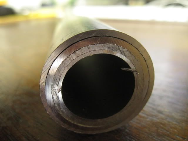

I have plenty of 0.058" wall 28.6mm (1 18"OD) alu tubing...pretty close at 25.6 mm internal.
I can cut the slot, so the wedge works..How long do you need? 100mm ish?
Yours for £3 incl post.

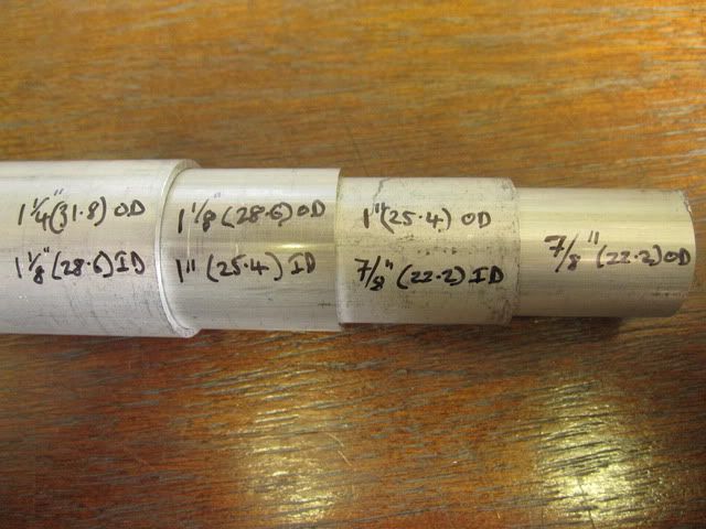

Yes, I think you are...:wink: it needs to be 1/8" smaller all round:
The inside diameter (ID) of his 1 1/4" (31.8mm) outside diameter (OD) steerer will be 1 1/8" (28.6mm). The ID of a 1 1/8" (28.6mm) OD steerer, for which the stem is made for, is 1" (25.4mm).
Therefore he needs something to bridge the 28.6mm ID of that fat steerer and the 25.4mm OD of the undersized stem quill to fit inside it.
If his stem quill was 28.6mm OD there wouldn't be a problem.
That seatpost shim is 1 1/4" (31.8mm) OD, 1 1/8" (28.6mm) ID, same dimensions as the fat steerer tube in question.
To summarise:
1 1/4" steerer tube = 1 1/4" (31.8mm) OD, 1 1/8" (28.6mm) ID & stem quill OD to fit
1 1/8" steerer tube = 1 1/8" (28.6mm) OD, 1" (25.4mm) ID & stem quill OD to fit
1" steerer tube = 1" (25.4mm) OD, 7/8" (22.2mm) ID & stem quill OD to fit
