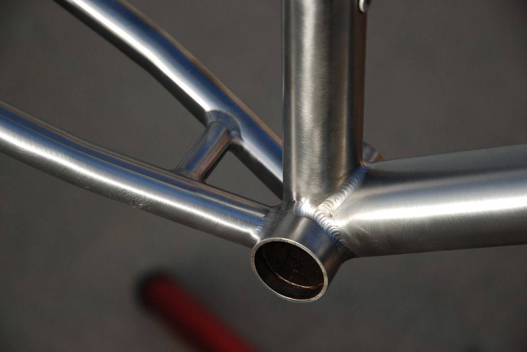

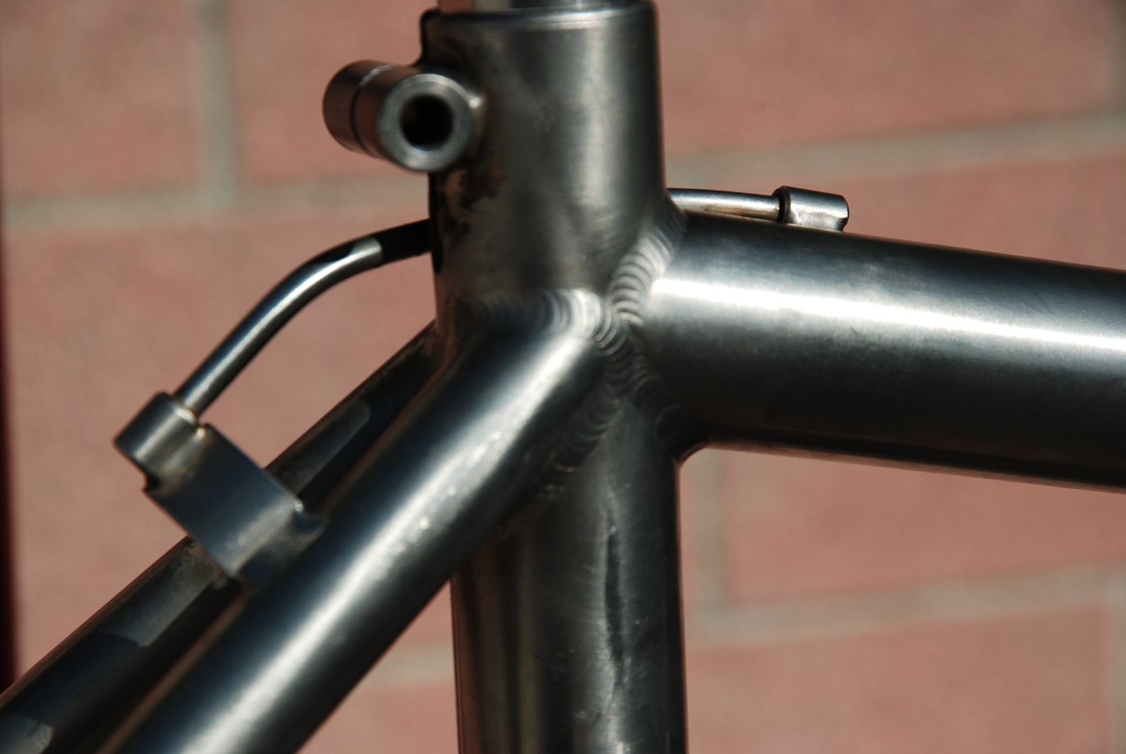

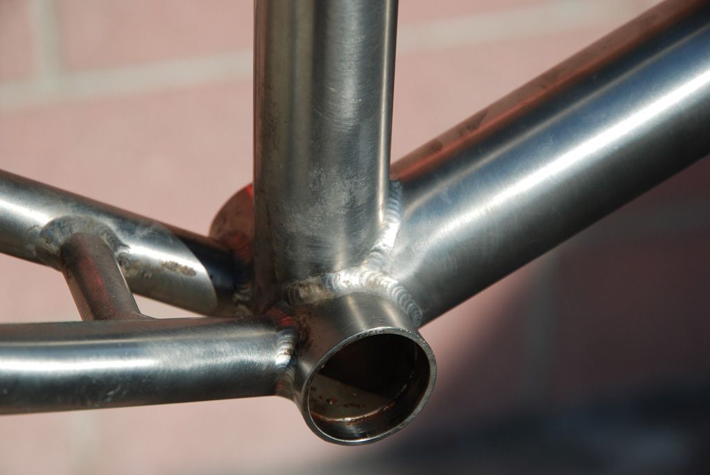

Seeing as though I've bee slow as molasses to finish this build I figured a build thread might help get me in gear. So here goes.

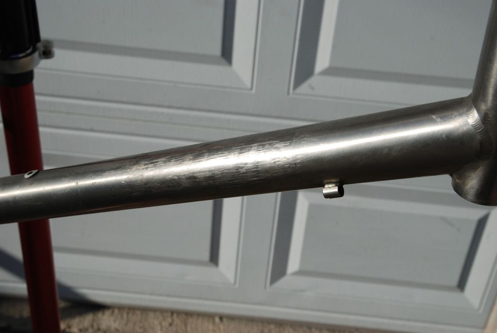

Picked up this bike on Criaglist for $200 complete with M730 XT and a WTB roller cam, not bad. Frame was in rough shape, no decals, all scratched up but solid. Parts were in meh condition but salvageable, especially the RC.
Pretty rough...

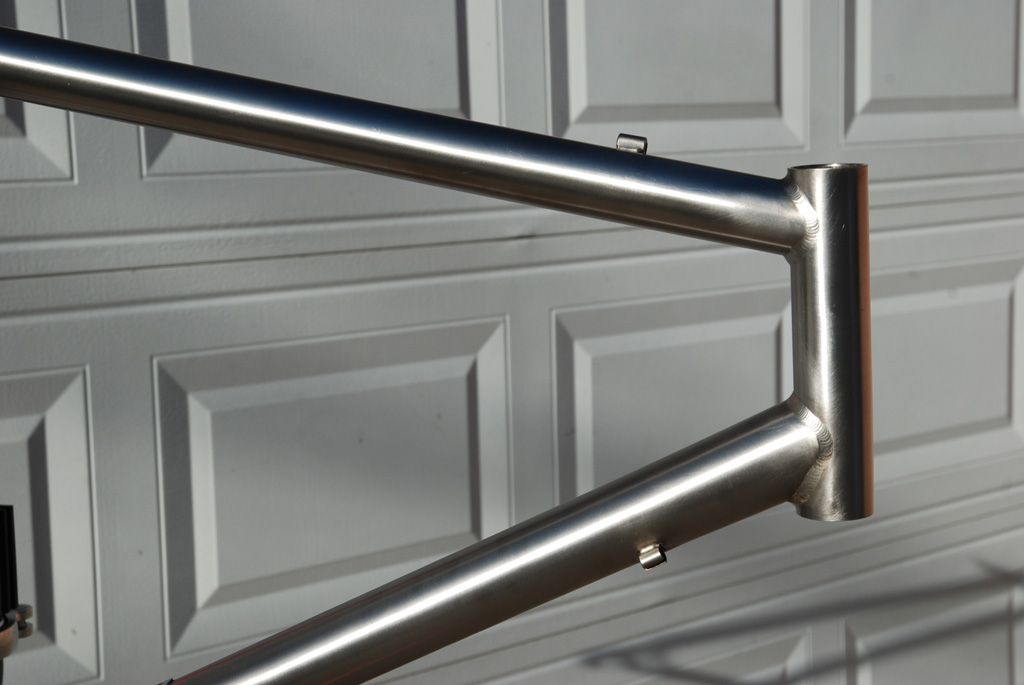

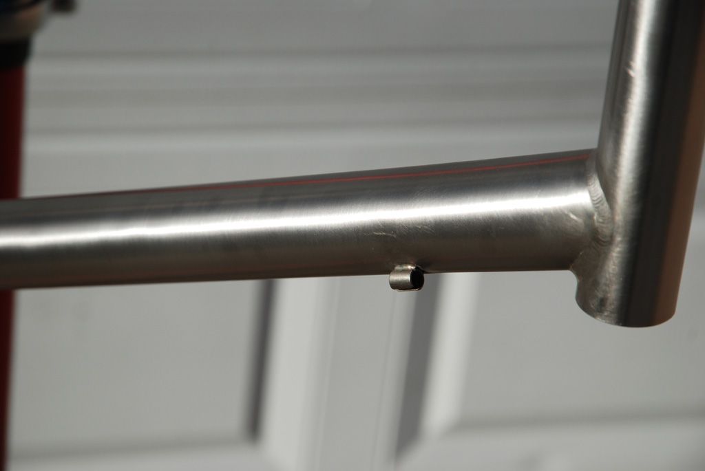

But after a little bit of work and a couple sheets of scotchbrite pads it's looking pretty smart!
Skip ahead a few steps... add some nice OEM transfer decals (none of this Velocals BS), a few clean parts and it's starting to take shape. More build pics coming soon.

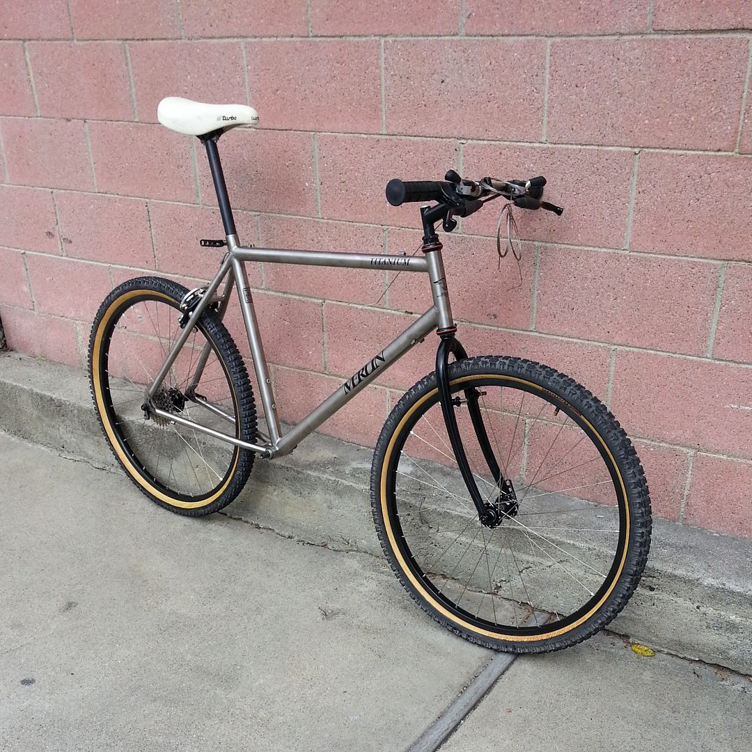

The build plan is as follows:
Koski fork
Salsa stem
Merlin bar
IRD post & Turbo saddle
XT Shifters, brake levers, cranks, and derailleurs
WTB headset, hubs and rear roller cam (maybe front in the future)
Specialized Ground Control front tire and GC Extreme rear tire

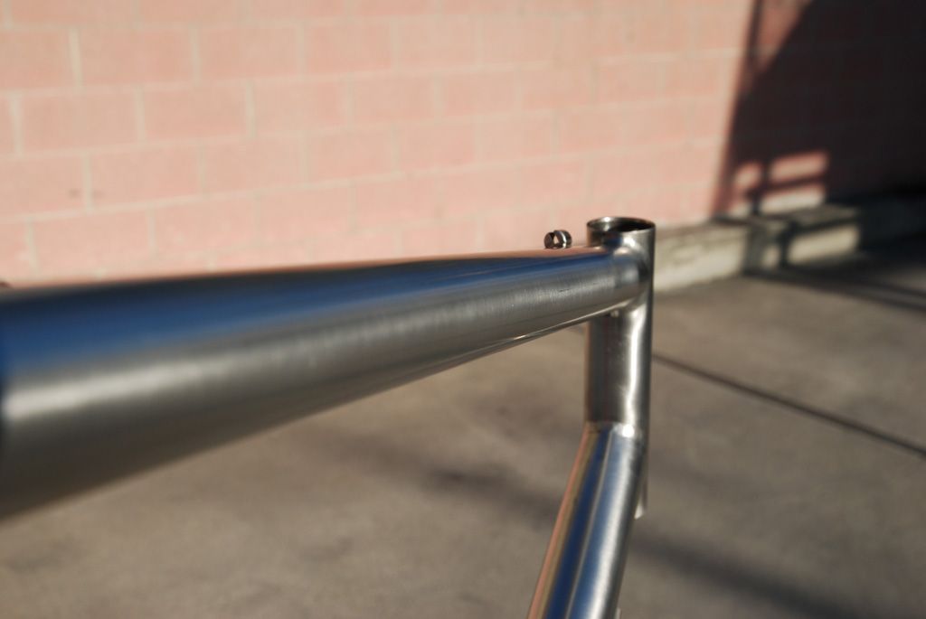

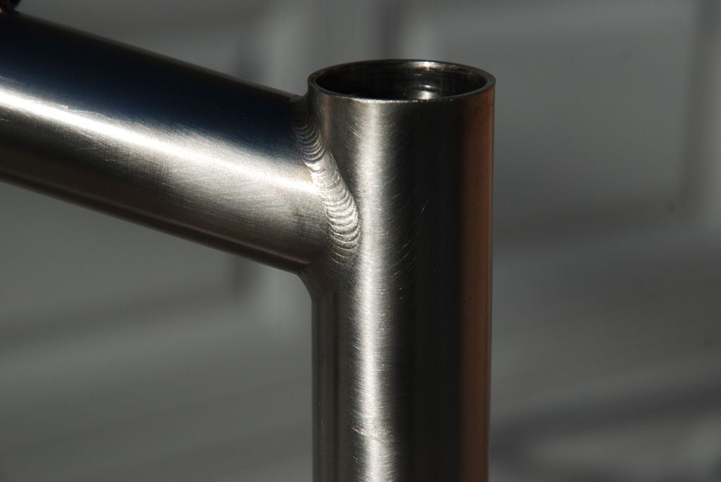

I was excited to see this project, great project! I am in the same stage, I'm thinking whether to give the scotchbrite.
as you used the scotchbrite?
in circles or along the tube?
is high gloss or matte?

I used long pieces of scotchbrite pads, maybe 1.5 x 8" and pulled them back and forth across a small section of the tube perpendicular to the length of the tube if that makes sense. Held one end in each hand and pulled it back and forth while rotating around the tube. Used three different grades of scotchbrite, coarse - medium - fine. Finish is matte just like the original.
