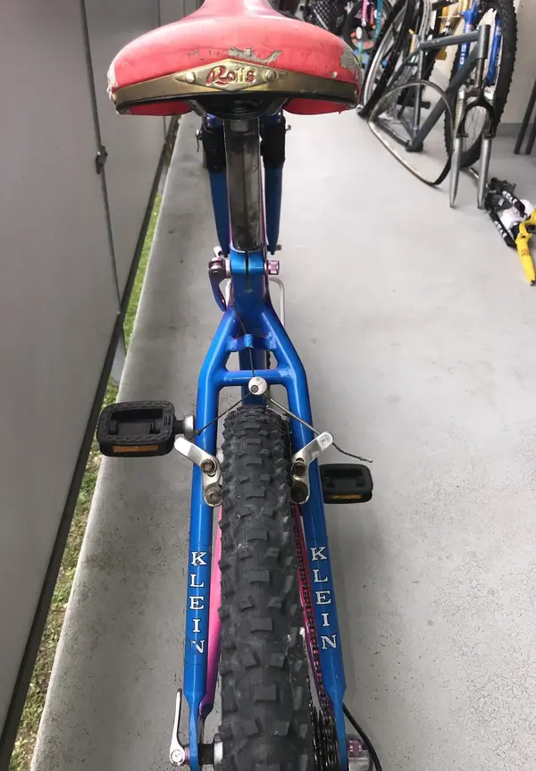

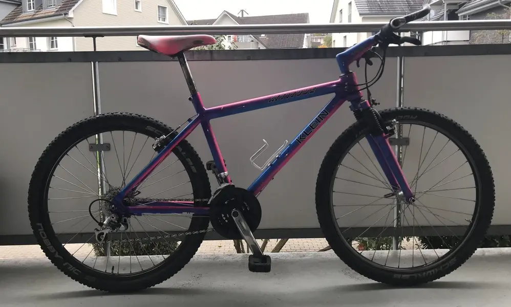

She's in kind of rough shape. I knew that going into the deal this will be a long-game project. No worries.
I picked up this 1992 Klein Attitude from a nice older man who said its been sitting for years next to a window in his shed. This is evident by the stickers that were on the top tube and handlebars that were removed at some point, revealing the amount of fade on the paint.

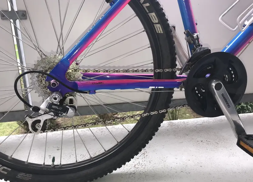

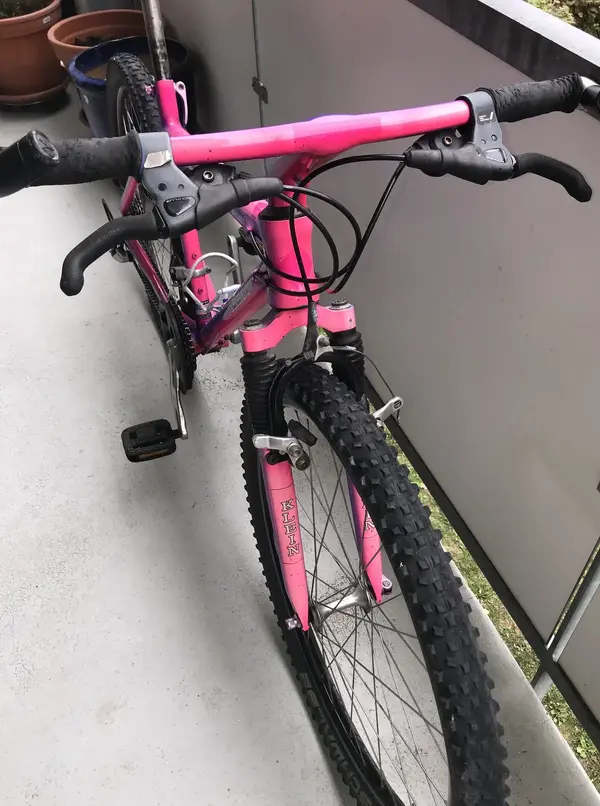

The front fork needs to be serviced. The paint needs to go down to the bare metal but there are no dents or gouges. At one point the man changed the cranks to the currently photographed Shimano Unobtainium cranks shown here, such that his younger sister could ride the bike around without getting her dress caught between the chain and the chain rings. What a nice bro! The original cranks are MIA. The original Dia Comp 987' cantis are there. Most of the original XT stuff is there, but the mechs are in bad shape with scratches and the front cage is pretty rusty. Seat post is visually destroyed. All of the internal cable routing is there. Ends of the bars are a bit out of round from over clamping climbing bar ends.
I have at my disposal everything laying around to do either a period correct XT or XTR build. I have most of the parts to do the 'Ultra Light' build aside from the hubs, Suntour XC Pro pedals and a few tiny (and affordable) parts here and there and Klein 2.1 tires.

I'm sure these cranks were OEM equipment on Klein's back in 1992? Or was it 1993? ;)

Love this find @bchicks if it had a Klein rigid fork it would be one step up for me but also really love the matching RS currently fitted. I imagine the RS steerer is unique to the Klein headset requirements?
1993, but the cranks and pedals were only available to team riders. There's an obscure picture of Tinker Juarez in a Czechoslovakian issue of Mountain Bike Magazine, circa 1994...but I can't find the issue at the moment. When the country dissolved, a lot of historical record was lost as well.

Mhm, the steerer is unique to Klein but several makers of the same year +/- a few years also had proprietary steerer tubes. Klein goes one step further with the removal tool for the front fork and stem/handlebar IIRC.
