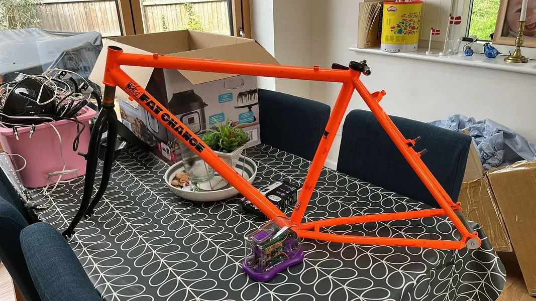

Wicked FAT Chance frame + fork…

I got it, a few lushed up the price on that one ☝️, now about this bottom bracket?

This one is a Medium unless I'm mistaken?
Having the original fork is a bonus and it has the correct seat clamp as well. Bearings are indeed easy to source, I'm just pondering how easy the BB axles are to come by though. Perhaps a threadless cartridge BB would indeed work?

You got a helluva deal there, as FATs always get painful when imported. The lockrings can be found below but there are other sources sometimes. You want an ISO 5/8 inch BB axle 122/3mm long for a period M730/2 Chainset or 127mm like the overpriced one in Romania below for a Cook Bros RSR chainset. Looking forward to the build thread you are in for a treat 😎

That's a White Industries (or Specialized) that's why it probably marked up.
But it's a bit damaged, the bearing look scratched and it's the Steel axle not a Ti axle version.
They are nice though, if its not just the axle you're after.
