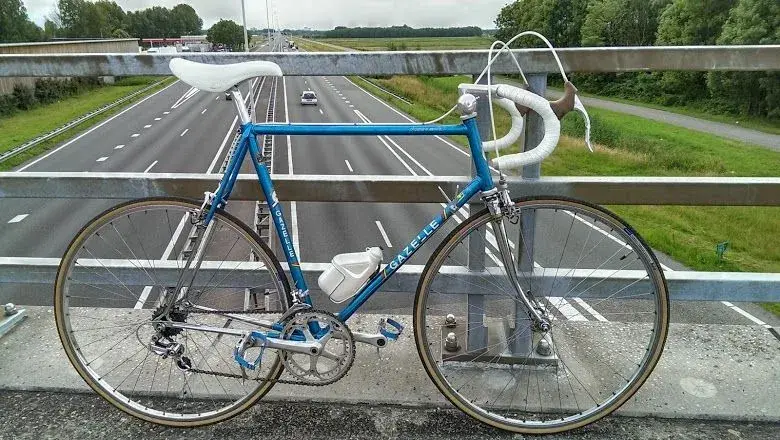

I have to agree, it's certainly not unheard of, but much more common on Batavus and Koga frames. My AA from '81 had contemporary DA 7200 shifters, brake calipers and wheels, the rest was more modern. So I concluded it must have been outfitted with Dura Ace when bought and fitted it out with as much contemporary DA parts as I could manage (it helps that I have no special place for Campagnolo in my heart, I'm struggling right now to get an NR derailleur to behave on a champion mondial cyclocross I'm building up) . So Dura Ace is certainly an option.
I prefer the Japanese option for he frame by the way, but that's personal. I'm always reminded of this bit in Back to the Future:
