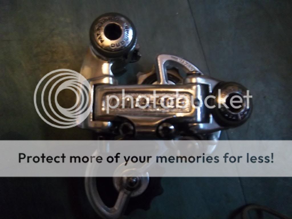

In the second half of the seventies there were three large Dutch racing brands: Gazelle, Batavus and Koga Miyata (Koga being designed and assembled in the NL). Koga and Batavus mainly fitted Shimano and Gazelle Campagnolo and Suntour. Somehow I still don't associate the earlier Dura Ace groupsets with Gazelle, but I do have some Dura Ace 7200 parts lying around...
I was originally building it with Suntour VX parts but the DA stuff appeared and i could not resist. So i have a box of VX bits now!!! I have not worked out what pedals to use - VX may be an option.
I think DA may be too high a class of components for the A-Frame but i like it a lot. And, as mentioned, there were no pics of a built up bike so the choice is mine (and yours).
