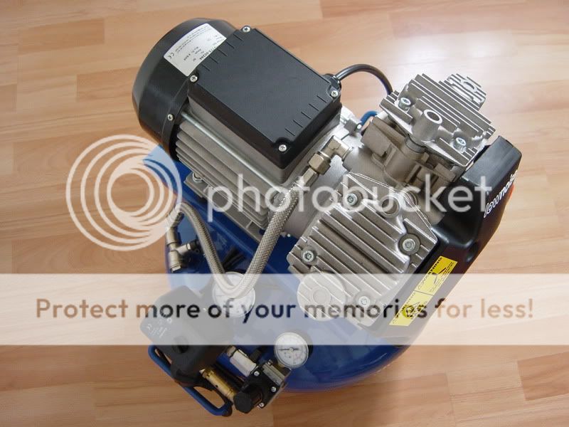

Look for something body shop style i.e. with a good size accumulator / tank.
I was very lucky and picked up a new medical compressor up from work :
But you could get away with something considerably smaller - the one above would do multiple bike tires on one charge no problem.
Like I said above, I reckon a large pump up spray bottle 'could' work, defo better than those mini compressors anyway ...
