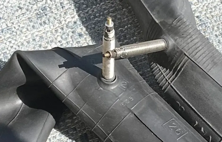

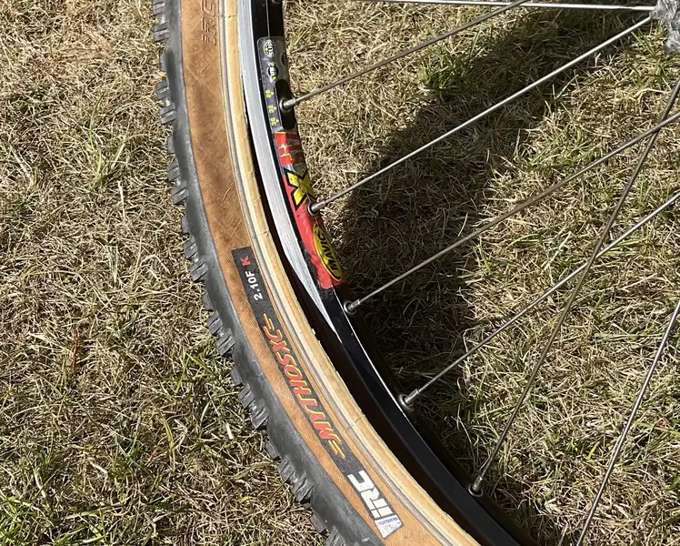

I’ve had say 12 to 15 punctures in the past 12 months, all on the rear wheel. Both Presta and Schrader valves. The punctures are always around where the valve metal sleeve meets the rubber tube. See pics 1 and 2.

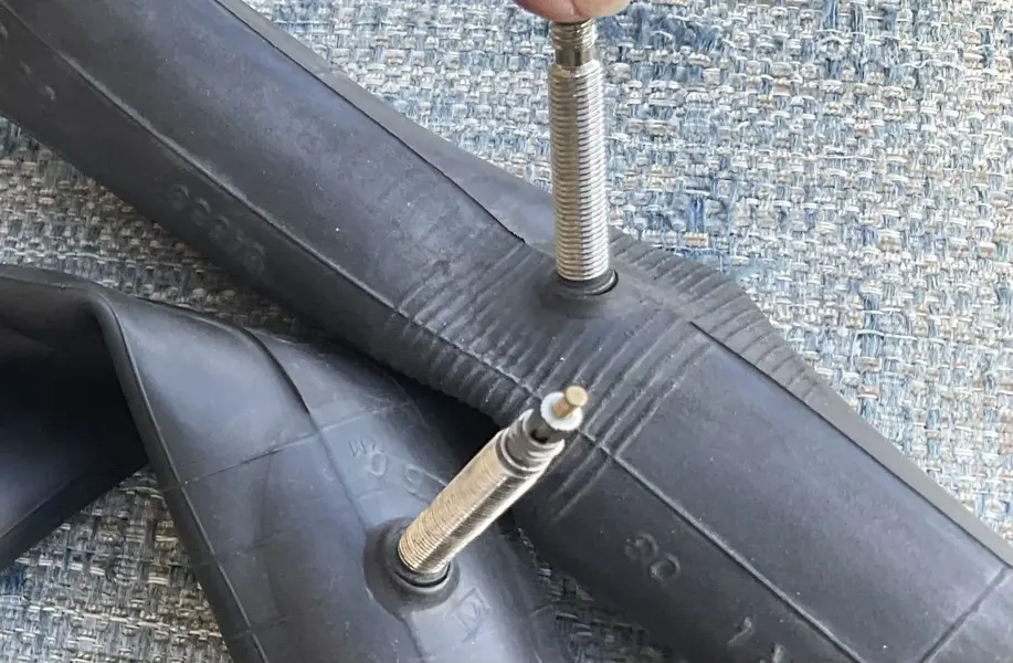

And once again I had the repeating puncture problem, this time a Mavic 517 rim. See pic 3.

Usually caused by the inner tube moving around the inside by the tyre under braking, also caused by a rough burr on the inside of the valve hole on the rim.
Check the valve hole on the rim for rough edges, if still happening some talc inside the tyre stops the tyre gripping the inner tube and dragging it round while braking.

It looks a lot like it is rupturing through the hole for the valve. I had this happen when using presta valves in shrader rims with a collar on the valve stem. Had 2 punctures on one ride in the same place as you. I solved it by cutting an old piece of tyre sidewall, punched a hole smaller than the valve in it and placed that over the valve hole inside the rim. It stopped the rubber bulging out.
Many thanks, I’m getting ruptures with both presta and schrader, however the schraders seem to last longer.
My last 2 ruptures were similar to yours, presta (with collars) in schrader holes. I’m going to try what you suggest and fit a tight membrane (from an old inner tube - plenty of them!) inside the tyre, fingers crossed the extra protection will save the day (and wallet). Thanks for the “heads-up”. 👍
