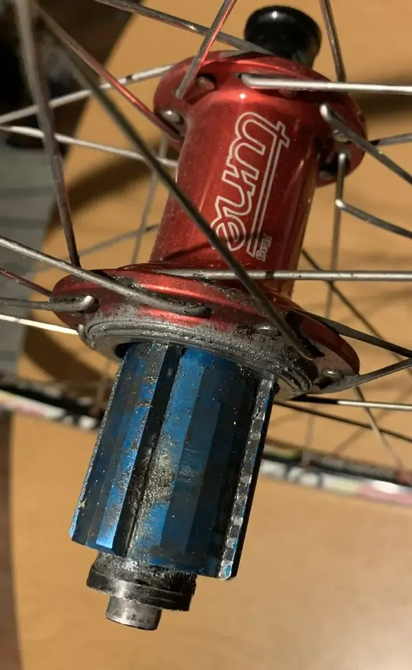

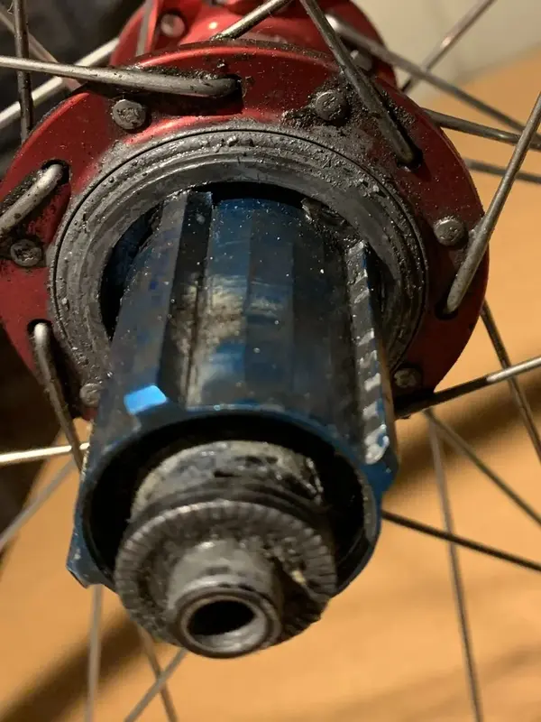

Hello Roadies, Is this a campag freehub?
I need to service these lovely tunes before I put them on my mongrel road build. Whilst I’m replacing bearings I’d also like to get the drivetrain sorted.
it looks like it yes - not the standard campag pattern but some were made like this to reduce weight or whatever. If it's not shimano then it's campag, there are vitrually no other options anyway
I think we have some replacement tune freehub bodies at work if you get stuck. They're not cheap though. 😬
That said, you shouldn't need to replace it unless you're swapping to shimano.
Thanks chaps, once I get into the guts of this I’ll know a bit more on condition. Hopefully it’s just a degrease and bearing replacement.
Campagnolo sprockets have either 4 or 8 mounting tabs. While not a hard and fast rule, alloy Campagnolo pattern bodies usually have 8 notches, while steel ones often have 4 or 5 notches interspaced with relieved sections to accept the additional tabs.
