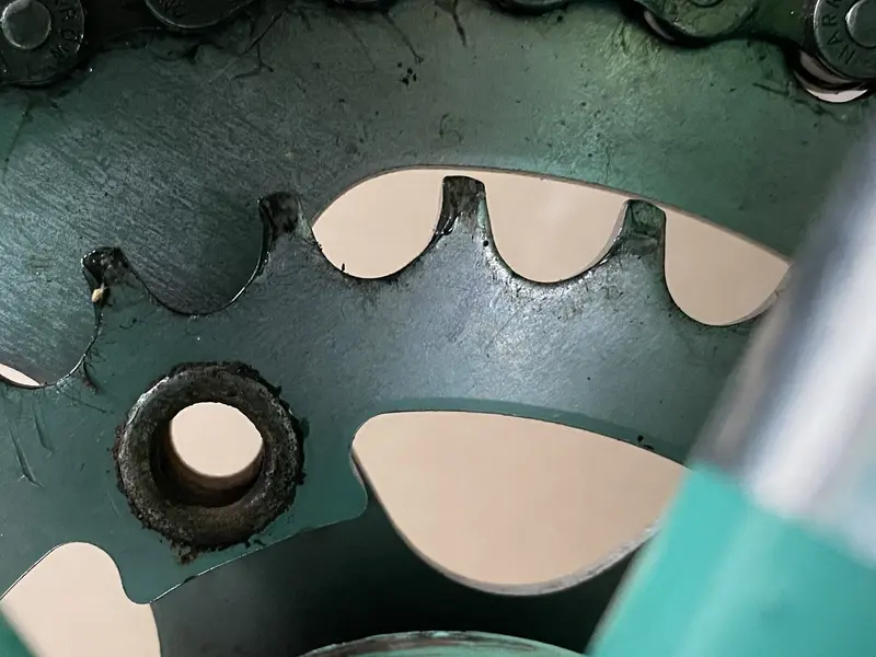

Hi all, so since getting my Raleigh Lizard back on the road, I’ve noticed a clicking through the drivetrain whilst in the smallest front cog.. under closer inspection, I can see that the teeth are far more worn than the other two cogs, creating an offset sort of shape between teeth.

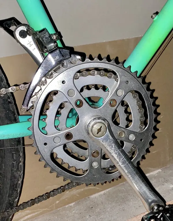

Do you have a pic of the cranks, or the code that is stamped on the arms, fc-m???
Thanks for the reply.. it has an M9 stamped into the arm if that helps.. here’s a picture (you can actually see the lettering on the crank arm).. IMG_5774.jpeg
Are those Sachs cranks (the front mech is)? Also don't think the rings can be replaced, but the teeth don't look that worn to me..

I’m not entirely sure of the brand of the cranks.. they are made in France, so I’d guess it’s likely that they are Sachs.. the front derailleur is Sachs yes 👍🏻
No the individual rings are riveted together, so can’t be replaced separately.. I will have to replace them as a set. It’s only the inner (smallest) ring teeth that are worn.. I will try and capture it in a picture.. they are definitely misshaped though..

Chainring teeth usually look hooked/like sharks teeth when they get very worn . But yeah, I don't think they're replaceable, probably require a replacement chainset as it looks like the crank arms & rings are a one-piece item .
The chain is brand new (Shimano), and yes the noise is only happening in the smallest ring.. regardless of what gear the rear cluster is in.. the second I drop into the smallest front cog, the noise starts.. it’s not just a noise.. you can actually see the jockey wheel carrier (or whatever it’s called) flicking towards the front. As soon as I change into the middle or outer cog, it’s perfect. The teeth on those rings have no/little wear..
