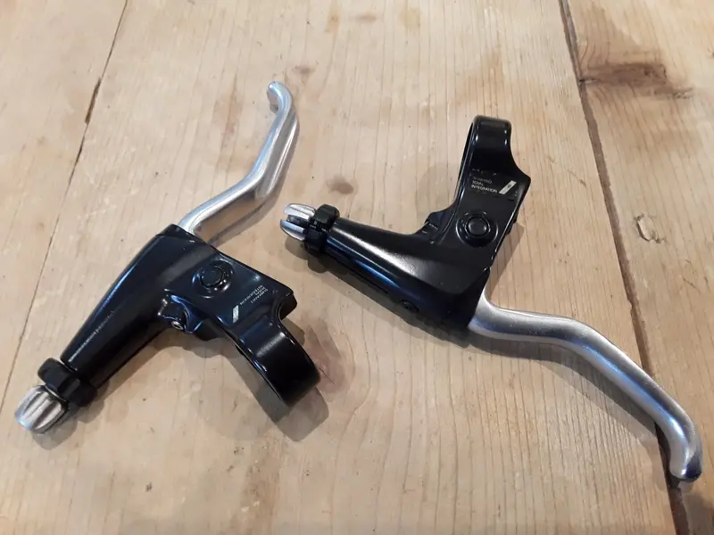

I was meaning you have nice shifters there, look for some levers without shifters attached and cut off the shifter hanger part with a saw/dremel/forge hammer/..
The XT levers are near enough the same, different colour. 737/738, harder to cut off the shifter hanger part though from memory. M095 mad the DX should be easier and still have the Servowave part, just a different finish seem rarer than the XTR though.
Or of course any other canti brake.just not the V-brakes you have.
Up to you on the straddle setup, I just like Shimano set wires as they work perfectly and are easy to setup.
Ah gotcha, these shifters and will go on my g/f's Koga ATB with V-Brakes.

V-brake levers have roughly half the pull of canti levers, they will function but it'll be death-grip riding all the time.
Some levers have 2 positions (usually marked V and C), you may be in luck. Otherwise there is a device to make things right, a rummage around on sheldonbrown.com will point you in the right direction. Also, ensuring your pads are as far from the pivot as possible will maximise your mech advantage.
