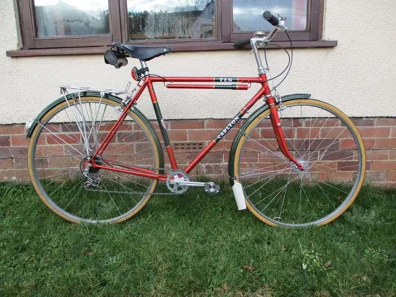

Converting a Ken Bird drop bar mixte to flat bar.
Got everything except the levers and I'd like to stay period.

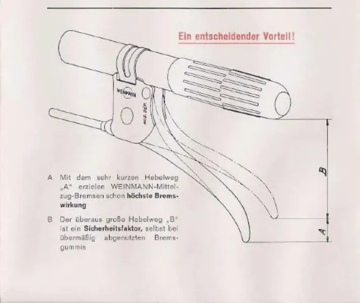

Excellent choice, according to Weinmann themselves in their September 1962 "Mitteilungen".
The short bit of lever travel "A" is enough for maximum effectiveness of your Weinmann centerpull brakes. "B" is just there for safety.

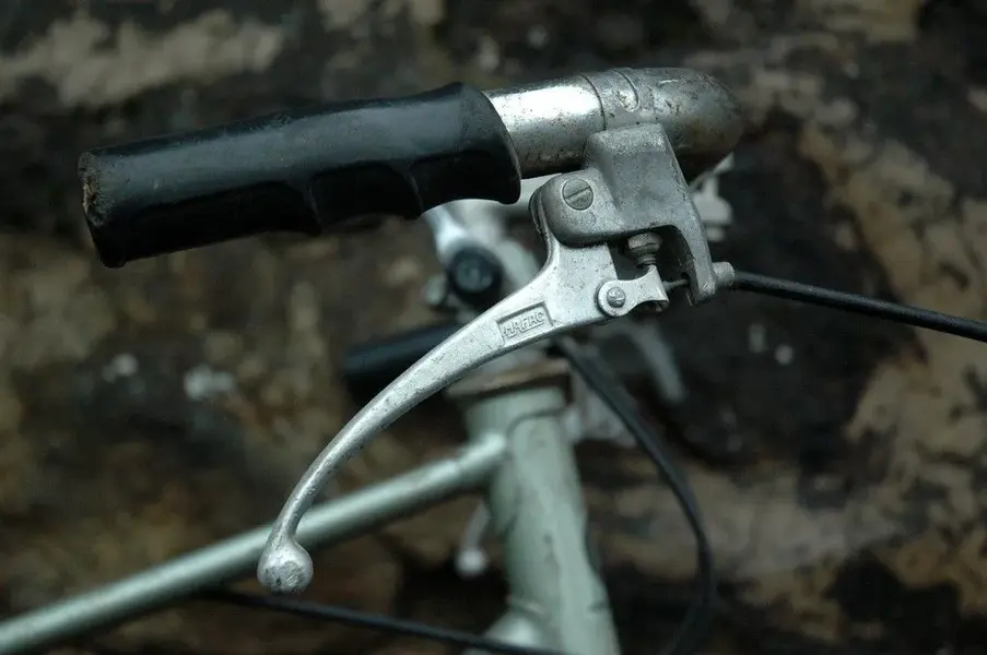

Like these ? Should be fine .

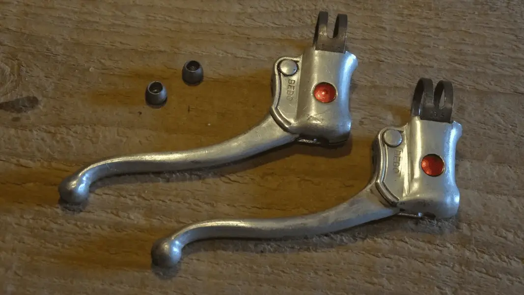

Bebo copy - or the Wienmann were actually made by Bebolux in Mandeure in the Doubs region France. Was a big supplier to Peugeot from the late 40s, but eventually went bust because they couldn't buy AL at a low enough price to survive. They are short pull, will work with Mafac centre pull (note the red accents) etc. perfectly. Perhaps Wienmann bought the design and tooling? They look so too much alike for coincidence.

The ones I posted are made by Dia Compe , I always assumed that Dia Compe were the source of the Weinmann brake products either directly or indirectly . With the emphasis on assumed . They are exactly the same as the Bebo though soo , every day a school day . Thanks wine drinking Eurobike snob . :)
The Mafac Ville levers are a far better more solid construction and uses normal pear shaped road cables, unlike the Bebo and presumably the Wienmann that use "MTB" cables with no cable pivot.

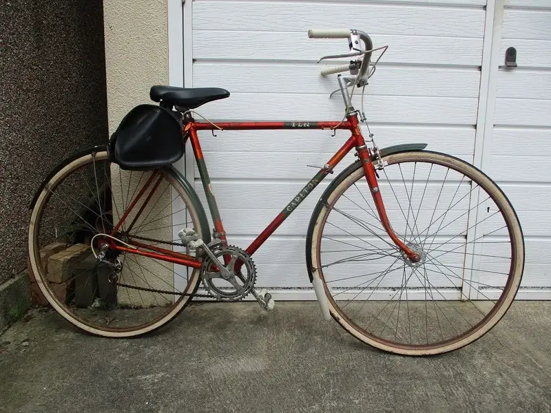

My Carlton has Weinmann centre pulls and flat bars with the original Weinmann levers and work fine, as well as I would expect 50 year old brakes to work.
