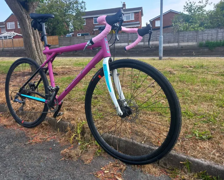

View attachment 793964View attachment 793965View attachment 793966
that is rather yummy, I do like a pink frame.

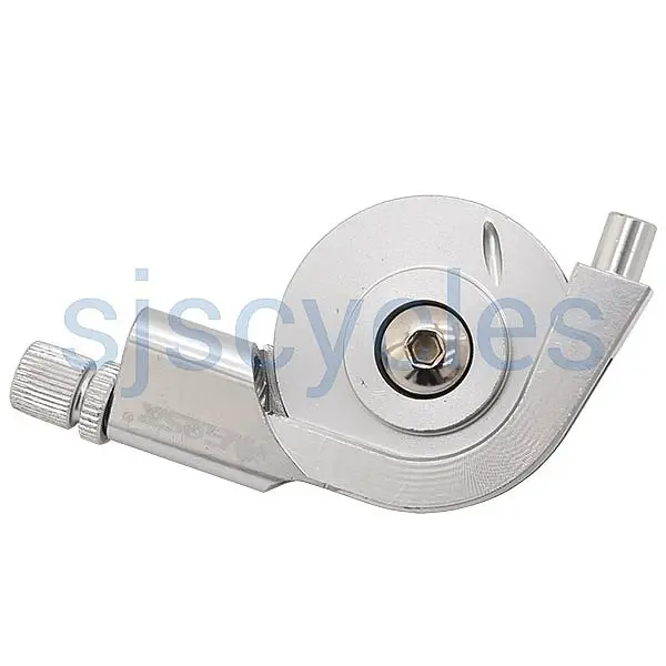

ok so i spoke to Ison Distribution today, asked about the Problem solver parts as they are the importer, they didn't have the inline version, but that wouldn't have worked anyway as it's supposed to be mounted on a redundant canti mount but they did have the V brake version, i have ordered a pair and i'm gonna have a play with them on a Rocky Mountain gravel bike i have in stock, it's running Sram levers on Spyre calipers and it's all spongey as hell!
this is what i have ordered and i'll report back once set up, might be a bit ugly but i'll be curious if it works
