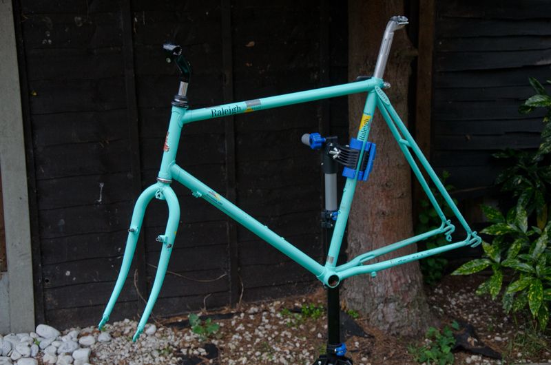

I've got a 1987 Raleigh Montage (whole bike), karma'd to me by Oaklec a few years back.
Realisation is that I'm probably not going to have time to finish it off. Would happily pass it on to you for the price of postage. It's 501 tubing, large frame, good condition. Would make a great tourer I reckon......
Drop me a message if you're interested..... :)
Not much there not to like...to be really picky two rack bosses at the top of the seatstays would be nice...but P clips will do fine. Nice classic steel frame, you will have loads of fun! :cool:

That orbit looks interesting, it also looks bigger than 22", it might be worth asking how he measured the frame.
Shirlylocks Montage, is also a good bet, particularly as it's for the price of the postage. The thing that put me off that Montage when I karma'd it to Shirlylocks was that it has the brake mounts on the chain stays for a U brake. However, that was me being a complete plonker, having built up an old bmx for my kids, I've realised that U brakes are pretty damn good and that diacomp make some fantastic ones. Looking back, I wish I'd kept that one and karma'd the canti brake one. The U brake version is much more interesting. The only disadvantage with the montage compared to the orbit is the lack of rack mounts, but as posted earlier, that can be overcome with P clips.
