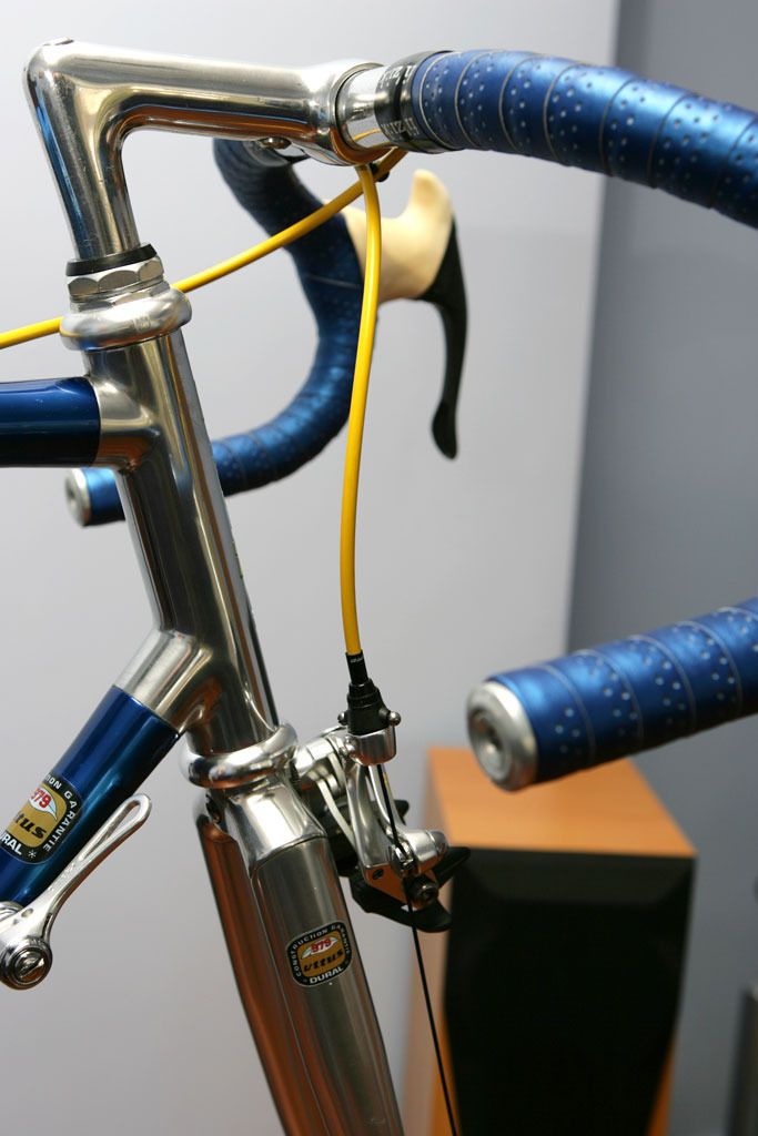

Bars: The Cinelli 65-40 Criteriums are out and 64-42 Giro D'italia, donated by Borris4, are in. The Giros are far more comfortable when on the tops climbing.

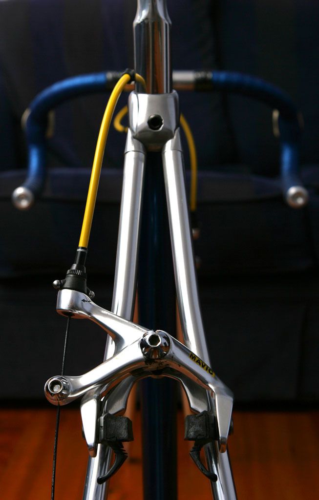

Outstanding issues: I can't get the Swisstop brake blocks to work silently in the SSC calipers. They squeal embarrassingly. The nuts and washers supplied with the swisstop are fractionally too big for the narrow slots in the calipers and I had to cobble together a mix of fixings from the original SSC shoes to get them to fit. They feel securely mounted and are properly toed in but there must be some flex when under pressure. So I'm trying to source some older style blocks to fit into the original SSC shoes.
