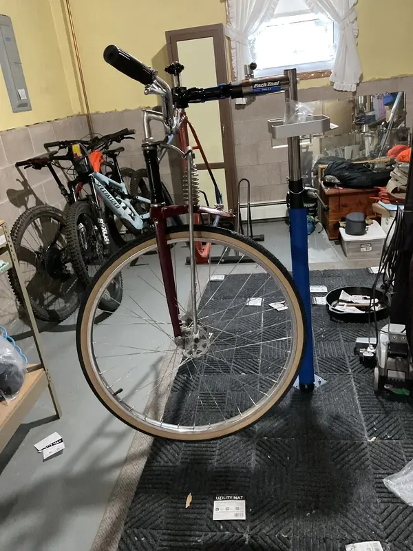

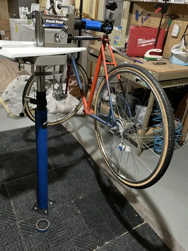

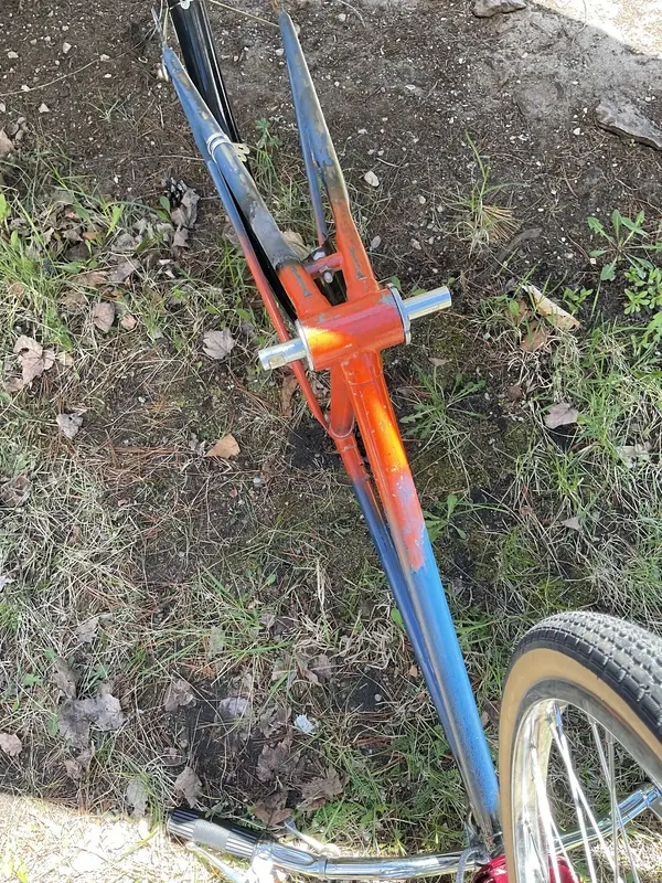

A little more progress today. 38 mm tires, a tight fit in the chain stays. They fit but might rub in corners. I’ll probably dimple them for extra clearance. IMG_0219.jpeg IMG_0218.jpeg

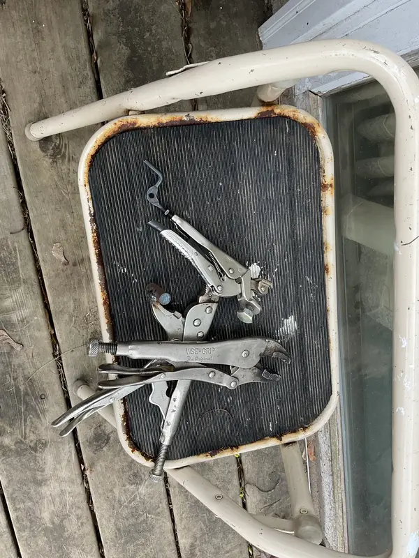

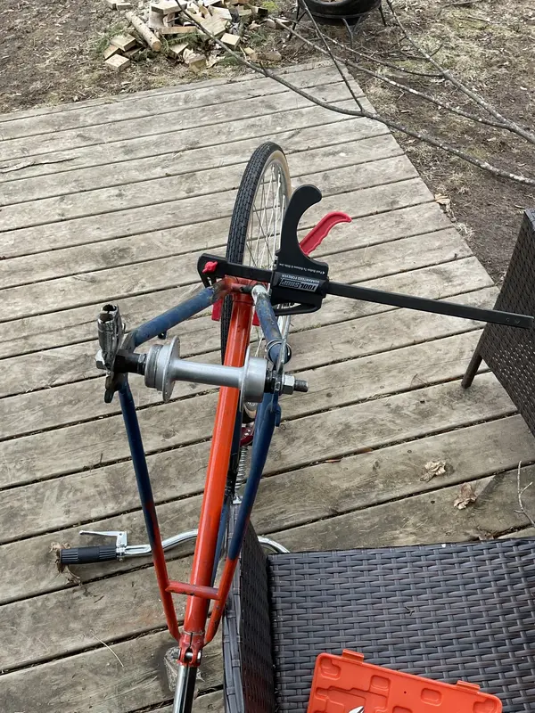

image.jpg The original chain stay spread was 44 mm giving 3 mm clearance on each side of the tire. Too tight. I first tried my standard mild steel chain stay spreading modes, with a torch, to no avail. Chrome molybdenum is too hard, especially if it’s already dimpled. IMG_0224.jpeg

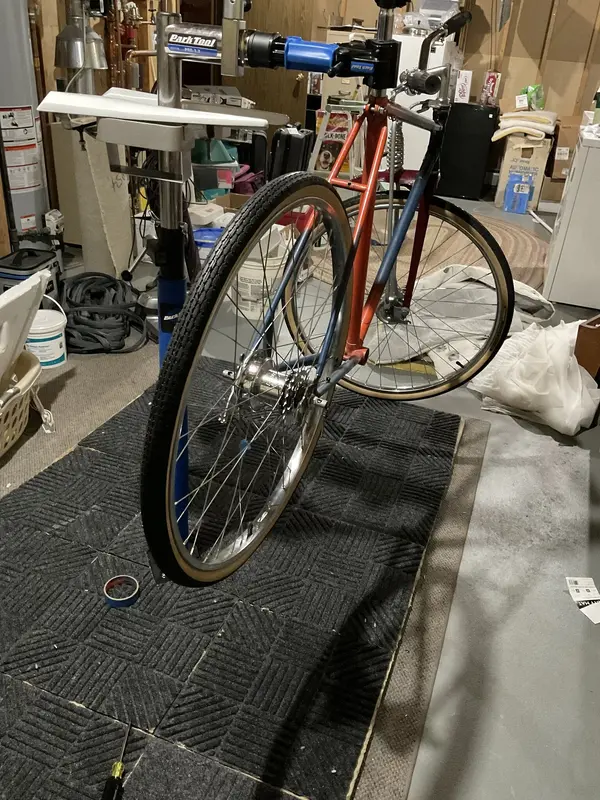

I used a piece of 2x2 inch square tubing and hammered it in between the chain stays. That spread it to 49 mm. IMG_0225.jpeg IMG_0226.jpeg

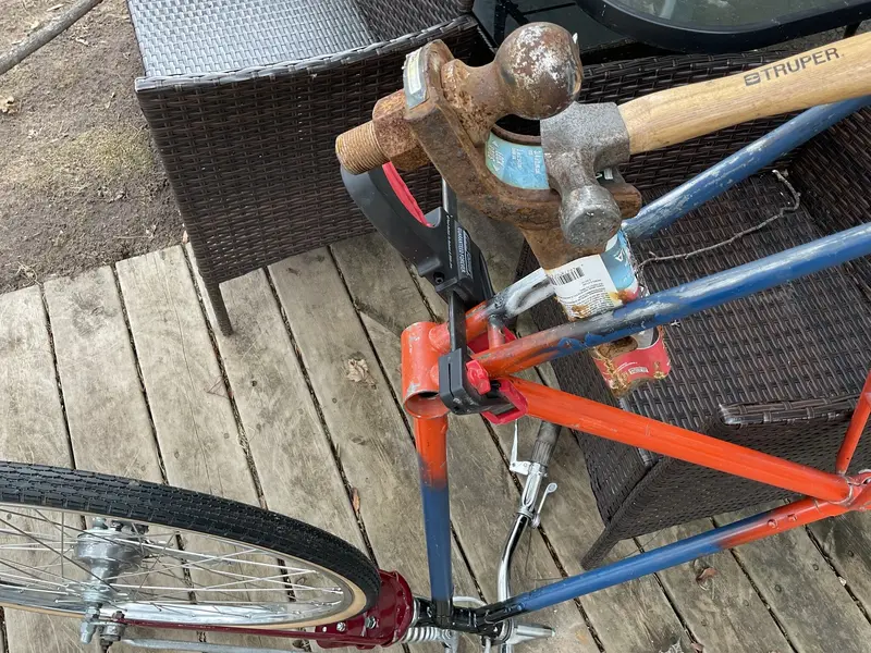

I need a sledge hammer to widen it more. Next time we’re at our house on the lake, checking it out, I’ll bring back a sledge and a huge splitting maul. If that doesn’t work I’ll have to cut tqo notches for the tire and weld in an indent. It’s pretty good, it a little more would be better. I bet the big hammer will give me a few more mm. image.jpg
