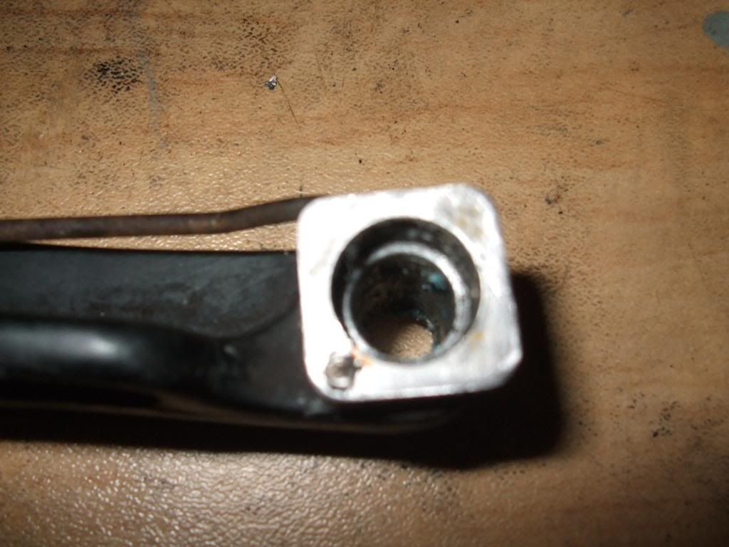

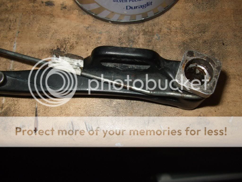

Here we go: Theres a small mark where i expected the pin to be, so thats why i think it has broken off
It might be you just need a new spring fella, have you seen if the spring part comes out of the brake arm ?
I have loads of springs spare in the workshop , which you could have, so might be able to salvage them ;)
