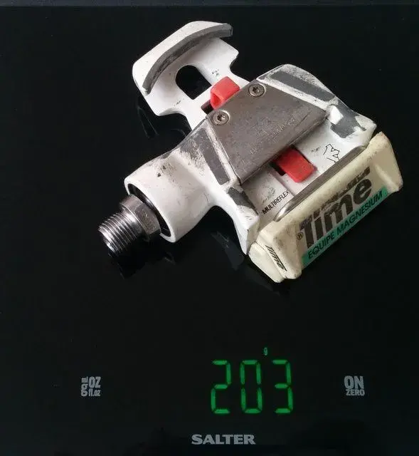

I think my Equip Mag must have a clump of mud on the underside :)
Here's a Shimano Look pedal for comparison.

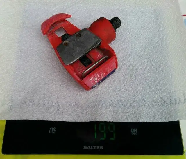

They're surprisingly light, presumably because the body is plastic.
I agree those pedals are shocking. I used to use them on a mountain bike and never cleaned them. Didn't stop someone paying £20 on ebay for them though!!

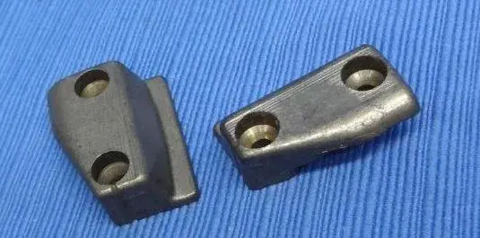

Wow that is a score , I bought a pair of NOS all alloy cleats for the Titan Mags off an Italian ebay seller recently , I have no Idea how they will last till I use them
