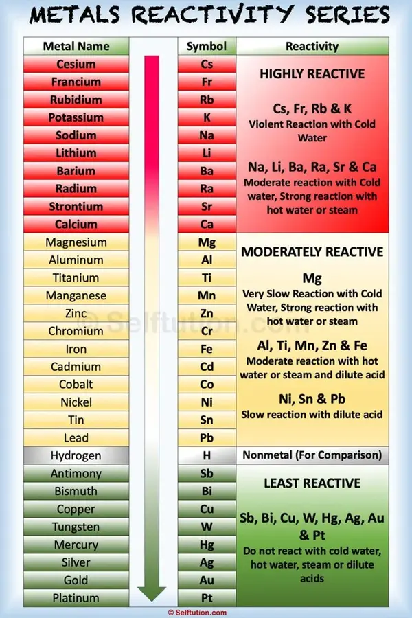

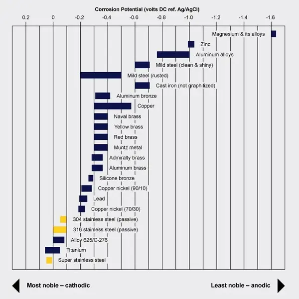

Presumably more to do with relative galvanic corrosion scale (where Ti and aluminium are polar opposites),
rather than straight material reactivity (where Ti and Al are pretty close).

As for metals in the red section I've seen lithium fizz and dance around on the surface of a tank of water and Cesium reacts so violently it was dropped with the dropper at a distance and blew the tank to pieces.
