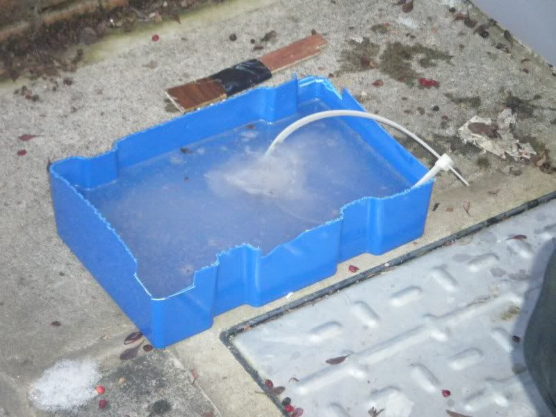

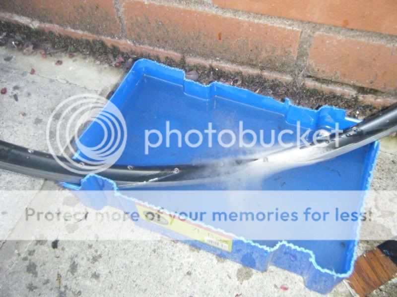

Wheels strip bath:
I did a test on a seat clamp before doing anything important!
Note shallow bath at this point, I was proceding cautiously
Wheels rinse bath:
Also of note here are the red bucket (filled to the brim with fresh water in case of splashes etc)
And check out my stirring stick! I couldn't find a bloody stick so had to make one!

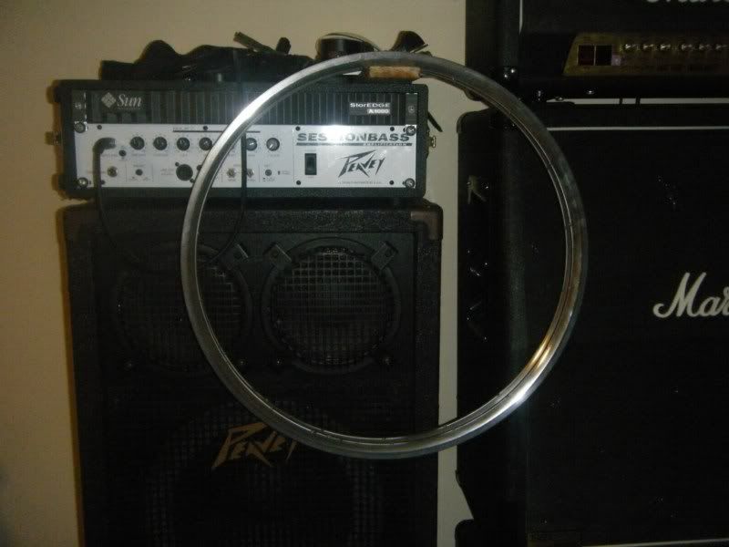

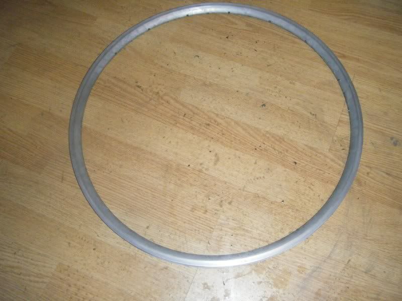

Wheels stripped:
Each section of rim took 10-15 mins depending on ambient temperature, took longer when it was colder
So the whole strip of two wheels doing about a 3 spoke hole section at a time, took a long time, about 5 hours actually

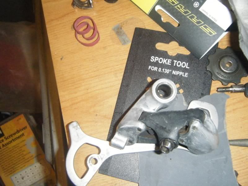

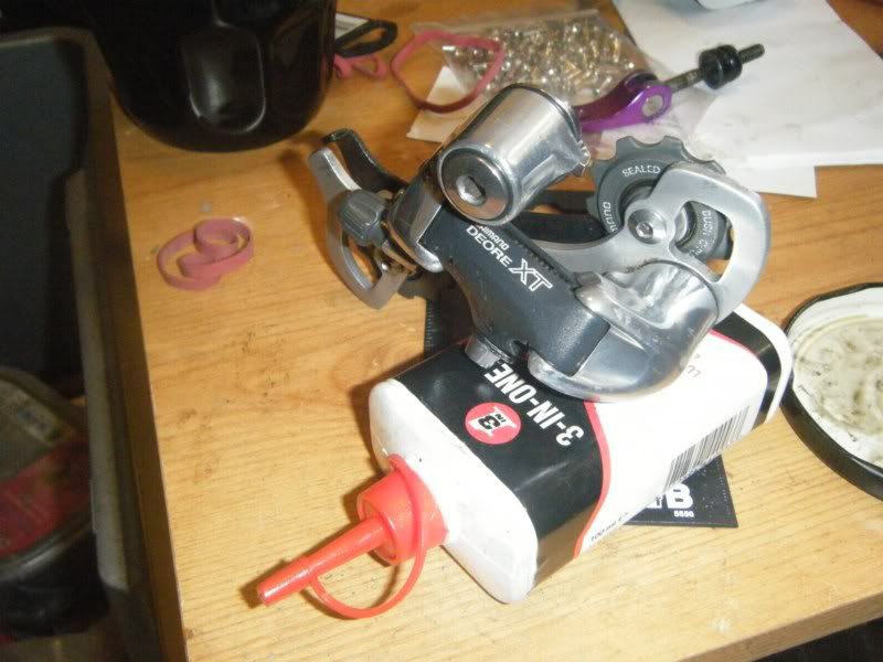

While waiting for dinner I switched the short cage rear maech for the long cage on one my CDales and rebuilt that rear mech
Done:

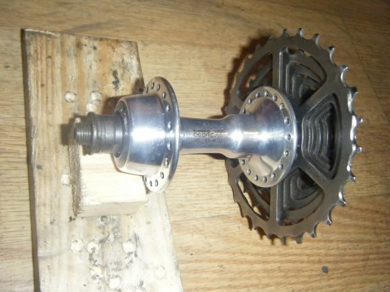

Cleaned up an 11/28 freewheel:
I'm actually gonna use this bike and a don't want it to pedal out (you know, when the bike is running so fast that your cadence isn't enough to put any more speed on?) Hence 50t front and 11t rear, also I live on a mountain so the tiny 24t granny ring will probably get used!

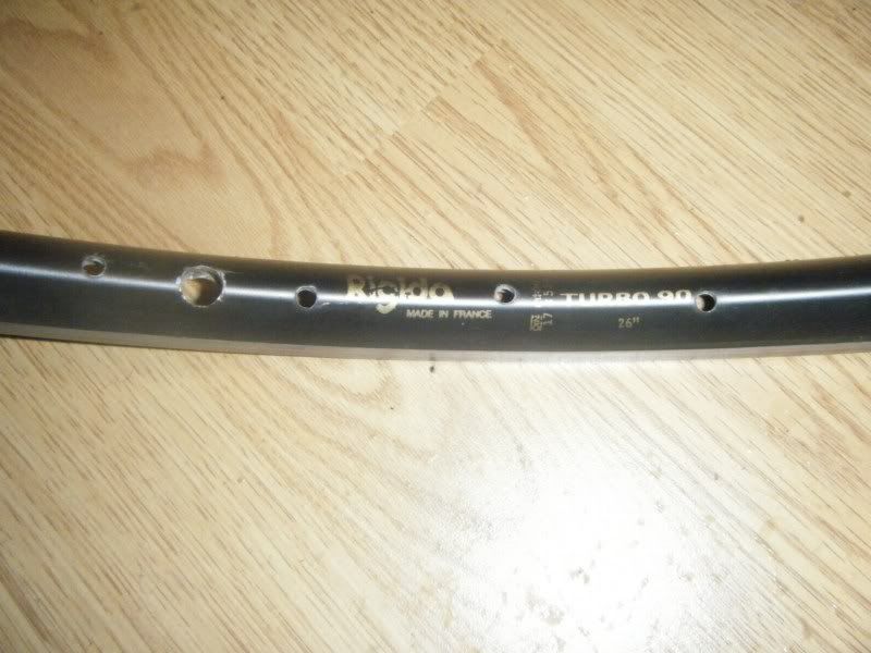

What the hell did Rigida do those logos with?

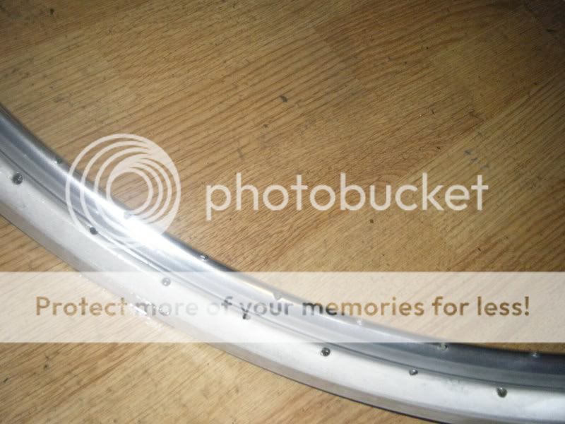

wheels compare
Wheels done
wheels done detail:
