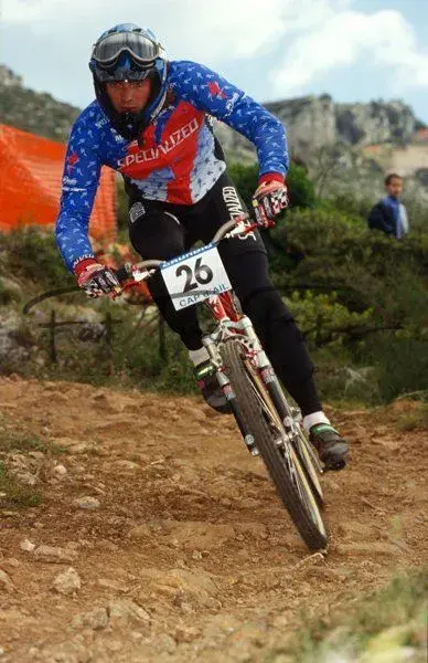

Opening pic on this thread the main body clamp is silver the pic above to me looks its painted red?
Looks the same chunky squared of design of clamp tho 👍
Found this pic....looks like it's from a great quality photo ....if there was anyway of getting that sharper ...that's the angle needed !
First pic on page.....
https://www.fattirefotos.com/jason-mcroy
Found this pic from the same May 1994 Cap D’Ail race which seems to help confirm a few things, all be it fuzzy: Looks like it’s a 2 bolt iBeam stem up front, more suited to riser bars. You can just about see the shinny front bolt bump above & below.
And I think I can just about see the waves of the black Onza Ules bar grips on a black riser as suspected. The rise doesn’t seem as big as Azonics making me think again that it might be a Club roost go fast to match, but not sure yet.
Still can’t quite see if he’s using a DCD or what colour it is. I’m guessing he is and it’s a 2 bolt silver but no evidence for sure yet, he’s had both red & silver versions mounted in the months prior/after.
