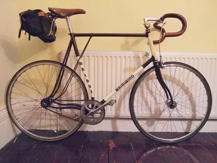

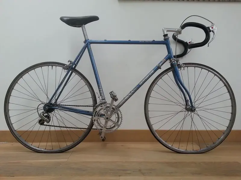

below 2 pictures I found after lots of googling
Blimey, never seen them before :D
Very Pinarello
Shaun
I'm not convinced at all. The snazzy 'Walrus' above was built by someone on Lufguss, and a (sort of) one-off.
Spot the difference...
(Click on the pic for a link)
