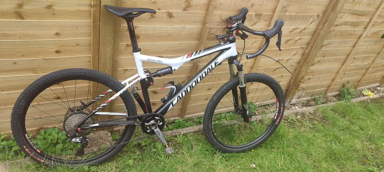

There are 3 different bars in the photos based on different options I tried. The ones from April have an old alloy unbranded standard drop bar. The photos from May have a flared alloy gravel bar that I got from Ribble for £6 (available from me for the cost of postage if I can find a box!) But I didn't like it and decided against flared bars in general. The latest photos from July have a standard road drop bar with no flare, a Cannondale Escape Hanger carbon bar, which is what I've settled on.
A bit delayed again as I wanted to get hold of a new stem and seatpost to make sure I can get the fit spot on before I complete the build with the brakes, shifters and bar tape. Syntace P6 inline seatpost brings the saddle a bit further forward and that's let me run a slightly longer stem at 65mm.
I also got a more recent set of Ultegra levers in the meantime which are a lot larger than the older style and I think the extra surface area will give better control off-road. I've run it up and down the road now as set up in the new photos and it's perfect👌it handles a lot better with the longer stem and there's also a bit more rise in it too, which I hadn't noticed but it gives a nicer position. I think it's going to ride so nice once I can get it out on the tracks and give it some.
Can't wait to get the brakes installed (just waiting for one caliper to arrive) and get out on it!!

I hadn't seen these, no! Looking at the description is almost a description of what I had planned when I started to think about this:
"Used to be if you wanted to throw drop bars on your off-road rig, you had to fork over your allowance for a new drivetrain and brake levers. We made the Corner Bar so you could conduct all your dirt-drop experiments with your current brake and drivetrain setup. I mean, why spring for the whole buffet when all you want is a salty snack at the bar?"
Though then again, I've done a couple of conversion-type projects that I've ended up breaking up, and by the time I got around to this one I really wanted to commit and try to make it into a proper bike where everything was completely compatible, the geometry worked and the spec made sense for the purpose.
And actually, it's now pretty much finished!
