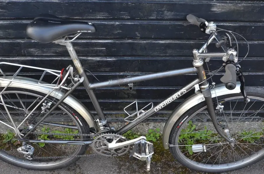

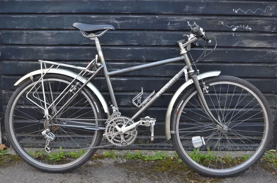

Now then, you guys might be able to help. I was looking at my bike a couple of months back and thought my frame might be buckled - if you look at the photo you'll see that the seat post isn't standing in line with seat tube. It leans forward very slightly.
I took it to a local frame builders, Vernon Barker, and he told me that the frame was true (phew) but the seat tube hadn't been reamed out properly. And looking back over the bikes in this thread if I crudely hold up a straight edge to my laptop screen it seems that my bike isn't the only one with this problem.
Is it just me, or has anyone else noticed this with their Overbury's?
It's often a problem with frames where the seat tube has been reamed out on a (badly set up) lathe.
I don't know if Andy P did it this way or not, but I've seen it on frames as illustrious as Yeti and Ritchey.
Pretty much impossible to do when reaming by hand, but a whole load less hard work.
All the best,
A frame builder has told me that they can re-ream it for me, which is an option. Probably not worth doing, but it's one of those things that, now I've noticed it, I see it every time I look at it!!!

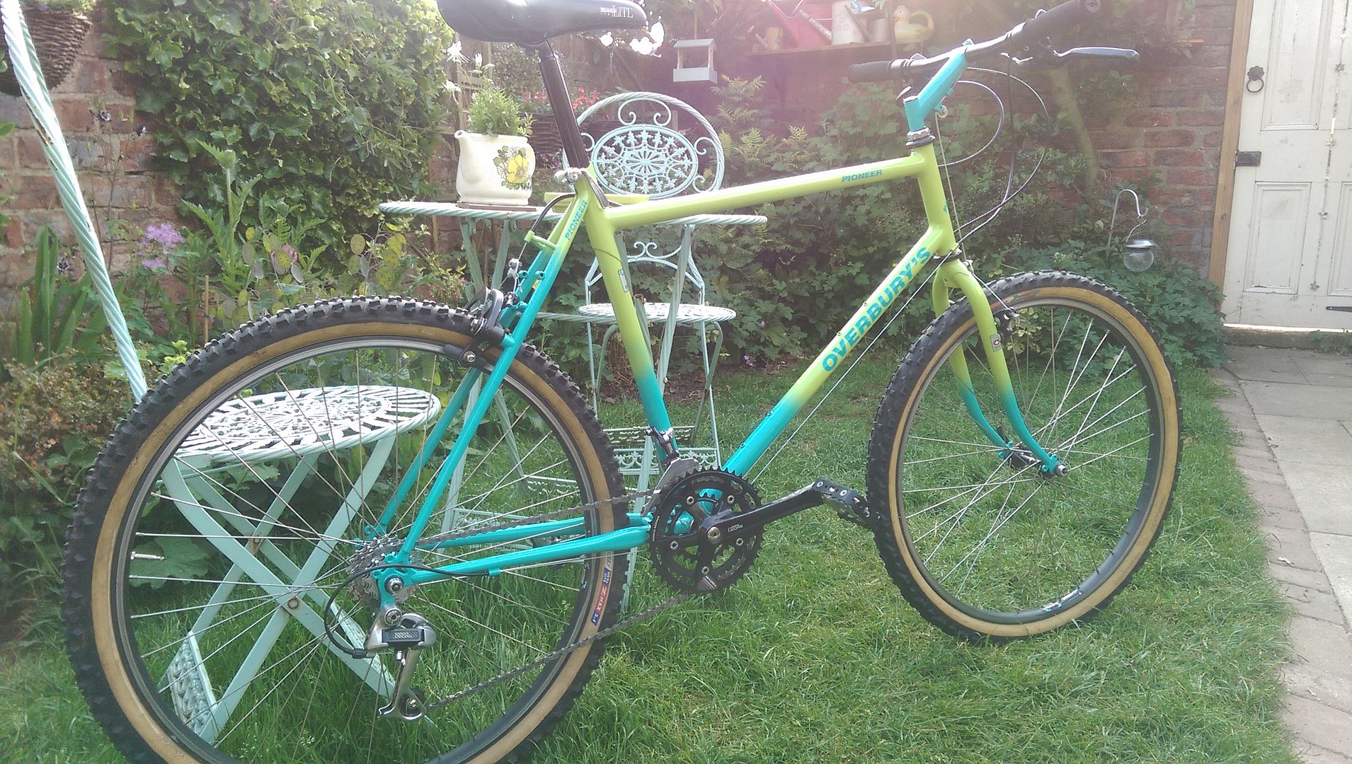

Bit of tweaking to go before I'm totally happy but heres my Pioneer
RBG
