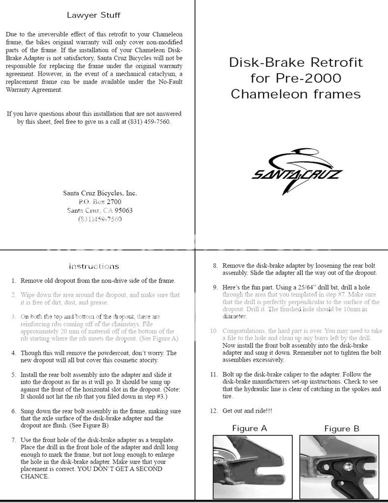

Oooh, yes please. It must be compatible with a '98 frame :)
You will need to adjust the frame to make it fit - basically file 20mm off the LH drop-out. You are supposed to drill a mounting hole too but I don't think it is really necessary.
I can post pics and the instruction leaflet if needed?
Here is the leaflet. The bracket is a tight fit and once the axle is bolted on I don't think drilling the hole is necessary.
Take care with the Dremel and hand tools - I took a morning to do mine - remember you can't put back what you take off...
I'll try and put some pics of my drop out up tomorrow.
Below is a stock pic of one fitted - you can see the problems. It's bulky as hell and weighs a ton, the disc caliper hangs upside down in an odd postion, you have a dirty great loop of cable out the back. I would think twice before fitting one again. An XTR V does a great job.
Oooh, not pretty is it! If you're running it geared, doesn't the rear entry only dropout on the left side make wheel removal/replacement more tricky? Especially with a disc to get in aswell.
