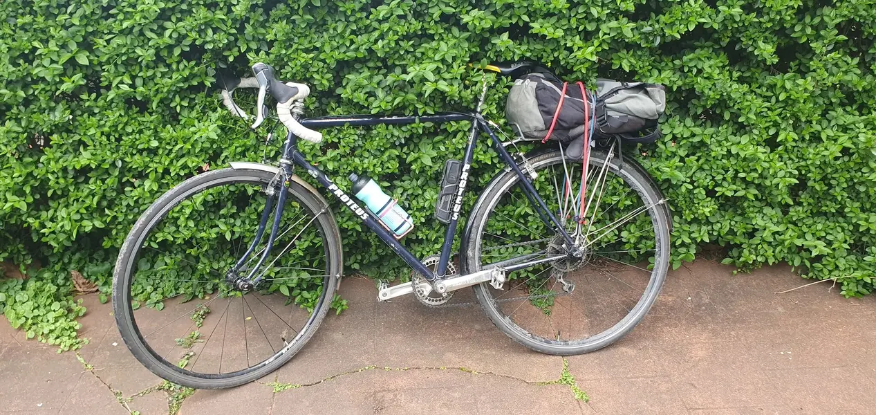

Hi - I have what I understand to be a British made Proteus frame (photo below - maybe I'll post properly about the frame separately as I'd love to know more about it.) and I'd love some help around the seatpost diameter.
TLDR: It came with 27.2 which was hell to remove or put back greased
bought 27.0 also hard to put in thuough in an uneven way.
will I break my frame if the 27.0 is actually too small and its just that the lug is warped/ deformed?
More detail:
right now I have an issue with the seatpost. I needed to adust it and it was extremely hard - but not impossible - to move. I finally got it out (by bracing a foot against the bottom of the triangle and corkscrewing for about 20 minutes). No aparent corrosion. the post was a modern alloy 27.2 that I assume the previous owner had put in.
I greased this up and tried putting it back - fet like hell so I stopped and tried with another post I have that's the same size - also hell.
also tried gently prying the slit open a bit - no help.
I wondered about a warped lug?? (saw that on a forum)
Anyway I ordered a 27.0 post
This is hard to push in at the top and then fairly smooth for about 150mm and then seems to hit somethingthing jaggy inside the tube that makes it very hard to move (and scratches the post? or maybe thats a jaggy bit where the seat and toptubes meet - also the jaws of the clamp slit scratch the hell out of posts)
I would just force the 27.0 in and call it a day BUT I'm worried that if this IS too small will the 0.2mm play cause damage to the frame over time? (I'm a faily llight rider about 75kg incase that factors in)
I guess I'm asking what are the possible causes of all this awful and will I break the frame using a 27.0 if its really 27.2 but the lug at the clamp is defrmed or some other pokery.
Thank you

Hi. Your Proteus frame was built in Warrington in February of 1992. The tubes were 531 Super Tourist 19/22g main tubes. These tubes have a thicker wall thickness than the lighter guage 531 Competition and after clearing post production take a 27.0mm seat post. Sounds like you need a reamer running through to clear any dirt and maybe bits of corrosion. Then a 27.0 seat post will slide on and out comfortably enough.

During the late 1980's through the mid 90's, I built a reasonable number of frames under the Proteus badge. Bear in mind that it was pre internet and at that time I had no knowledge of the American company. This particular frame produced out of the Warrington workshop in February of 1992 was for a lovely gentleman by the name of Ken Hartley, a stalwart of the Blackburn CTC group. I still have the notes. Ken knew what he wanted and specified all of the geometry and tube selection. The fork to this frame is particularly unique in being the heavier gauge Reynolds 531 continental style that Ken preferred for loading up the bikes front end with racks and panniers. He selected the Prugnat long point lugs and the cast bracket shell and the pump fitting that allowed a Zefal frame fit to sit underside of the seat stay. Surprisingly the frame still carries its original livery that was finished by C&G's in Liverpool. I hope this gentleman can get the seat post problem sorted out and make good use of a frame that is now over thirty years old.
How wonderful to get the history of the frame - thank you! I'll post up some more pitures - baring a bit of scuffing the paintwork in in god nic for its age. I noticed the pump fitting - what a nice detail - I'll have to get a pump to fit it. I plan on using the frame to tour with and I'm sure I'll get the seat tube sorted soon enough. Any more details greatfully recieved. and it would be lovely to know a bit more about the Proteus badge if you are willing to speak on the subject?
