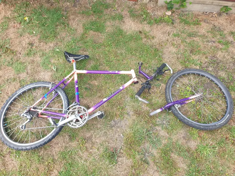

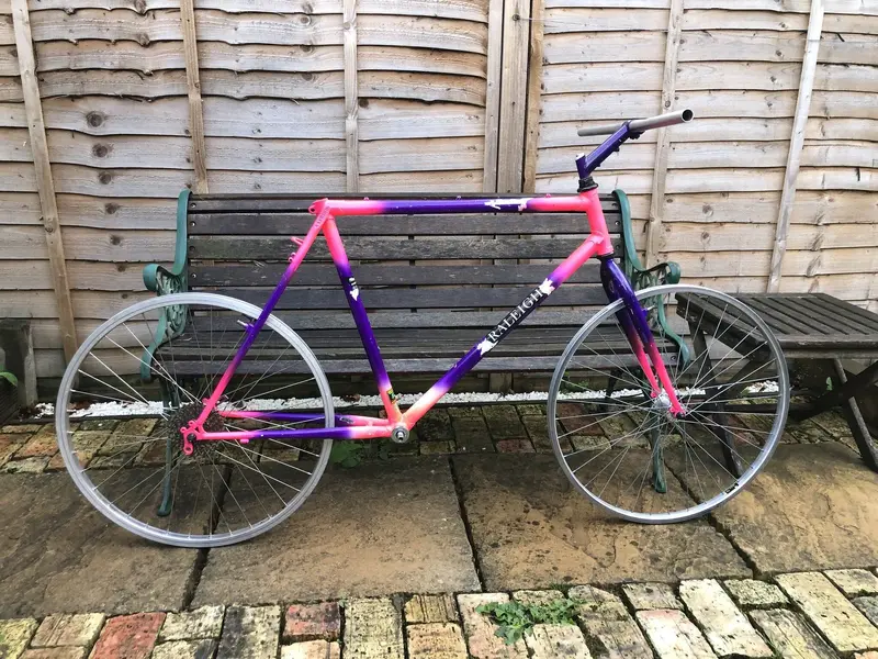

So this was actually posted on here for sale a while back, I must have missed it but it came up on eBay last month and was local to me so I thought I’d grab it - for spare parts if nothing else.

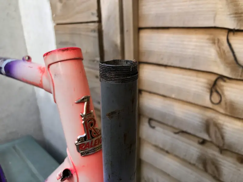

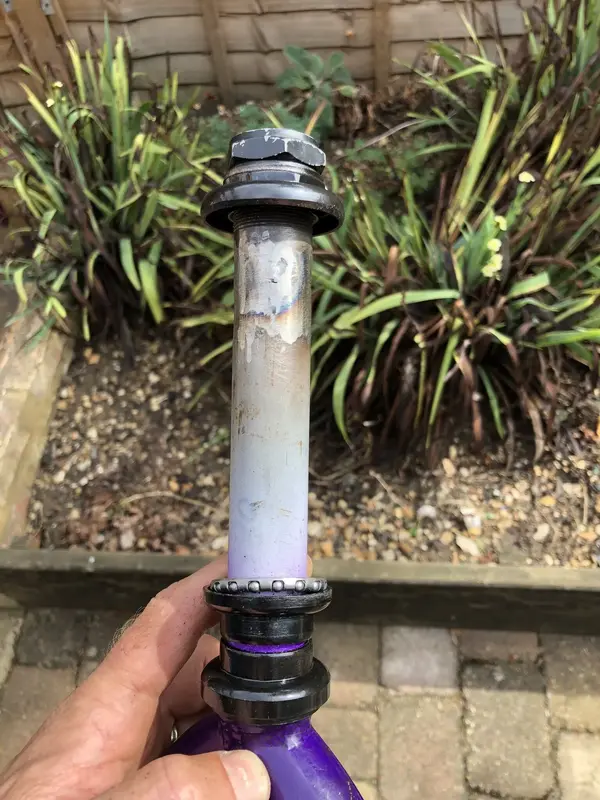

A young lad had been using it and had run the stem too high in the steerer resulting in a snapped thread on the steerer..
Well it yielded some tasty parts, XT brifters, Pace chainrings on MT60 cranks, DX mechs/brakes, so well worth the purchase price.

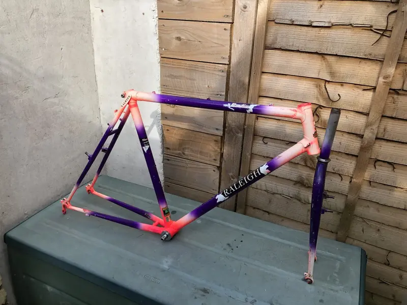

But I wanted to see if I could save the 531 frame/forks.. So I cut a decent thread off an old scrap fork I had and after a bit of measuring fired up the welder, fingers crossed..
Hopefully it’s a save, it seems lined up nicely and it’s certainly not going anywhere.

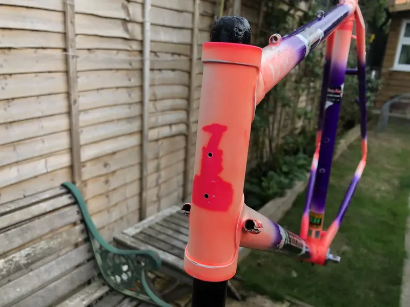

Next step will be a clean and polish of the frame and fork and I’ll be trying to re-spray the faded pink parts without sacrificing the original decals and purple areas which are mostly pretty good.
I’ll keep this thread updated as I go..

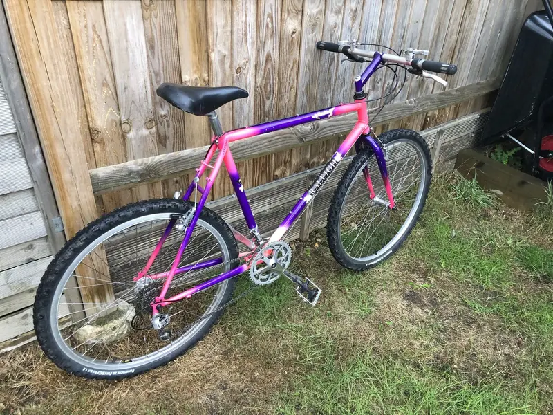

Managed to spend a bit of time on this this afternoon.

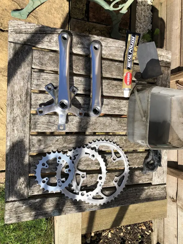

Original cranks were polished and I had some non biopace chainrings to fit, I went 2x7 in the end - left the granny ring off.
Went with some MT63 levers on DX brakes and these sweet Suntour thumbies I had. Found some Suntour mechs in my spares stash to go on…
8BF54022-484B-40B0-97B2-3338E3842B5E.jpeg 9A1C1621-13F1-4CAE-8757-FCF00A947AAD.jpeg

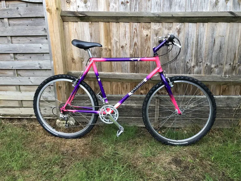

All ready to ride now, can’t wait til it stops raining here and then I’ll take a spin out on it and report back.. ;)
Managed to do a few miles on this over the weekend. I’m overall really pleased with it, the Suntour thumbies are a joy to use and the 531 frame/fork give a really nice rides - especially over graded trails I’m likely to mostly use it on.

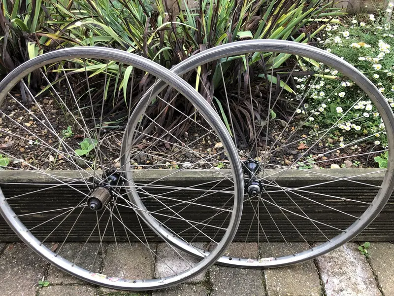

I altered it to 3x7 before I went out on it (well it’s actually an 8 speed cassette atm), but next step will be to fit these wheels and get it on a 7 speed properly:
6FB732B0-40C4-44F9-8A63-F43DA02EDBC5.jpeg D4DEDBED-C164-4AB5-9BF9-71957304E66C.jpeg
These Deore lx 560 were karma’d to me a while back and they should fit it better.
