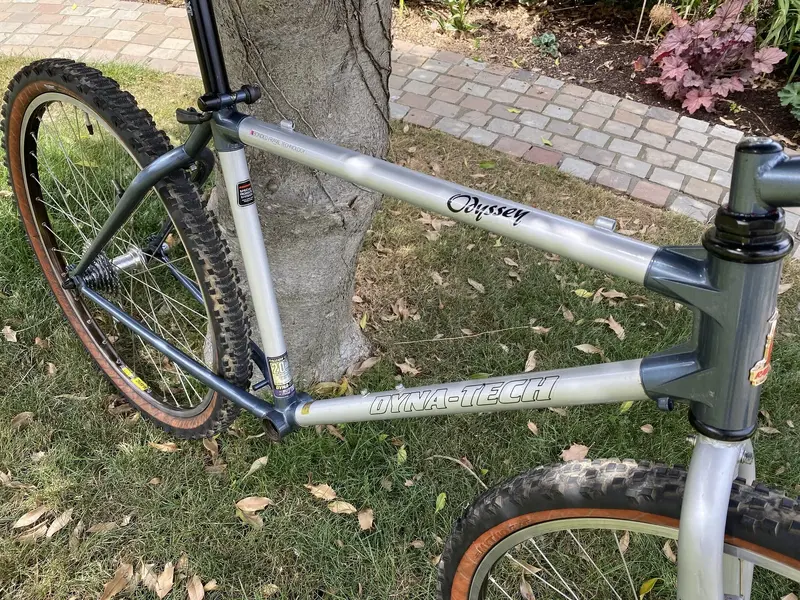

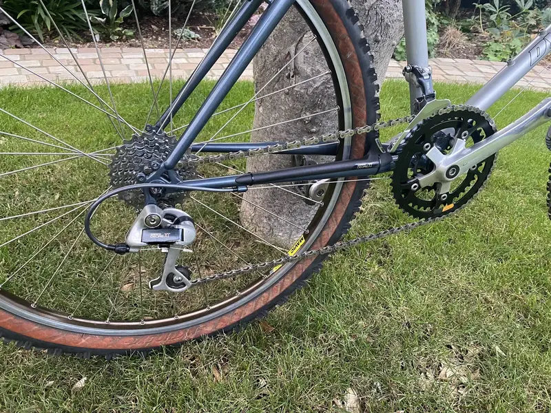

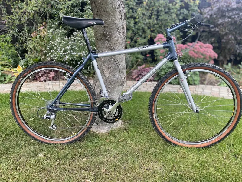

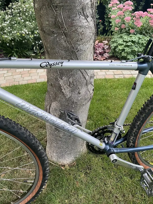

I’ve got hold of a frame that is what it says it is this time. Lovely condition and ready for me to transfer the parts off the imposter on to it. I had recently refurbished/cleaned the parts on that bike so should be a fairly easy swap, they aren’t perfect but are very close to what should be on this frame. M737 8 speed hubs for now with the extra click on the thumbies being used - that setup has worked fine on the other bike. Larger bike to smaller I’m hoping even the cables will swap as well.
I think that will be it for my Dyna-Tech buying now unless a 700 road bike frame appears in great condition in the right size. I love the Endeavour too @boy"O"boy but for me financially that’s an impossibility, I like catalogue correct if I’m building/buying a catalogue bike and the kit on those would be ruinous to my bank balance! I doubt there are any complete bikes still waiting to be found now.
Anyway, chucked some wheels/stem/seatpost on to get a quick idea of how it will look before I get off to work.

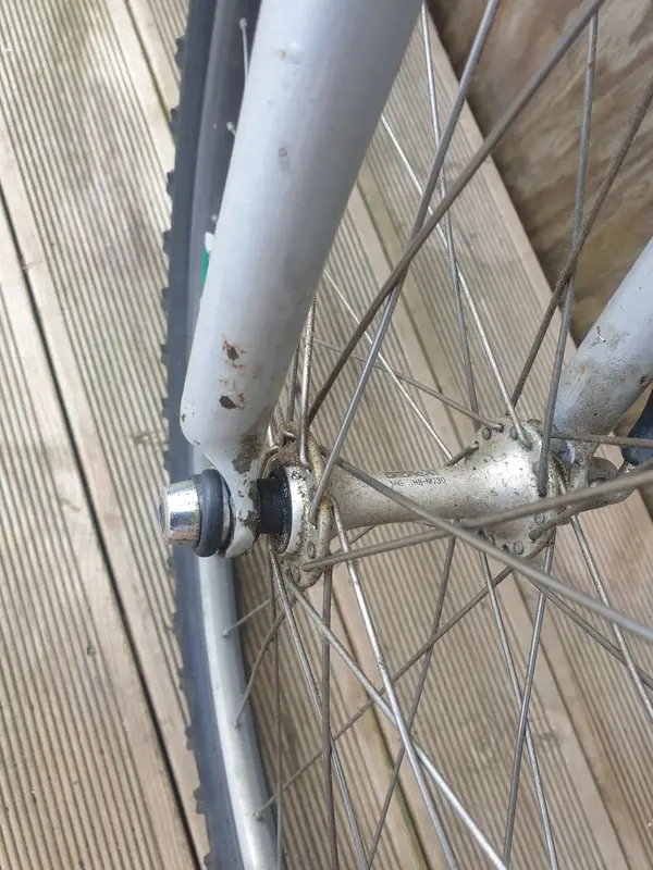

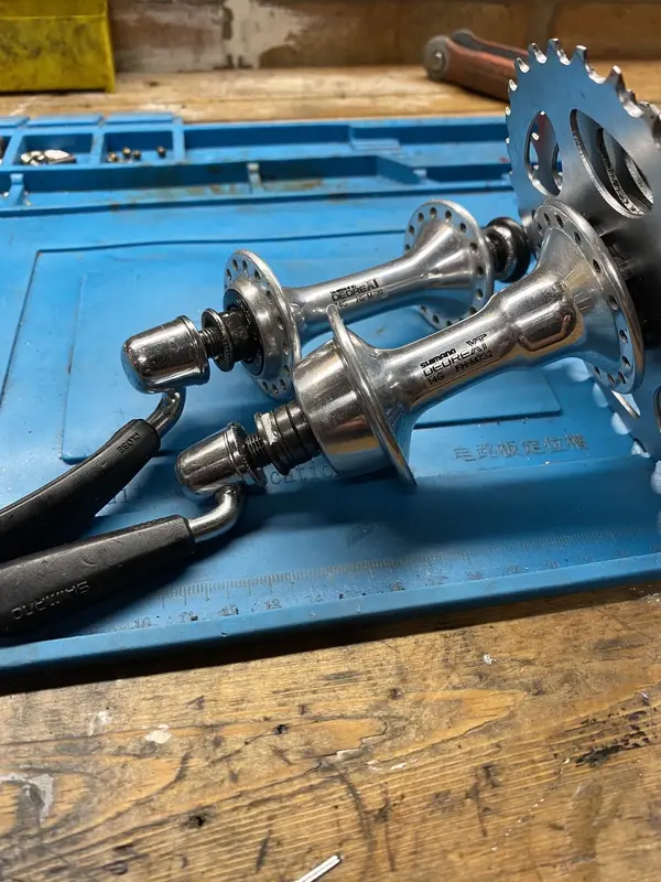

Well I’ve got some hubs, got the cassette. Spent a happy hour this evening putting new bearings in, front cones/lockrings seized on. Ended up having to wire wheel what looked like some sort of putty out of the threads to be able to undo them.
A set of new decals for both as well as some o-rings for the qr nuts.

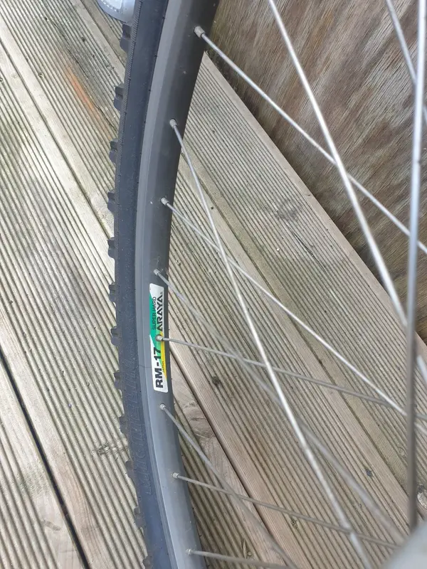

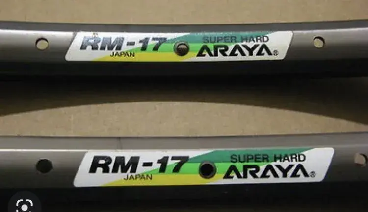

Just need to find some Araya RM-17 dark anodised in 32h flavour - anyone got a pair sat on a high shelf or a dark corner waiting for a new home? I do have some Rigida rims the same as on the Mission and Voyager but if I’m going to the trouble of building some wheels will wait a while to see if some come up!
4C8C2B43-7AA3-4862-AE54-4EFC0796D482.jpeg FFA43A53-70E8-48CE-A4DC-1B2E1D2EE306.jpeg
As is often the case I’ve hit a bit of an impasse, a break in proceedings, a stumbling block.
I managed to get a great condition complete front wheel from Scant, RM-17 super hard grey rim with xt m730 hub. Which makes one of the ones above redundant. So I’m now after a single Araya RM-17 super hard in grey like these so I can carry on with the build. Still got the option of using the Rigida rims which are the same colour……….but I’m so close…….

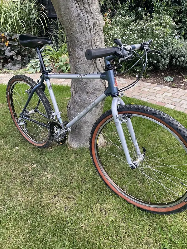

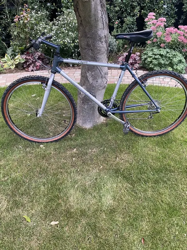

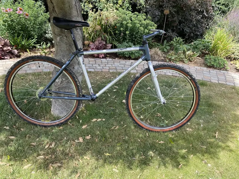

Bit of an update.

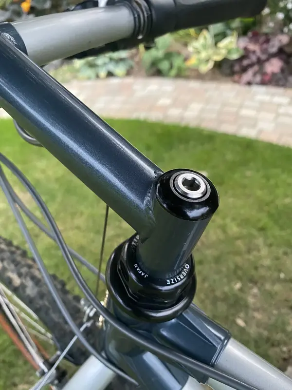

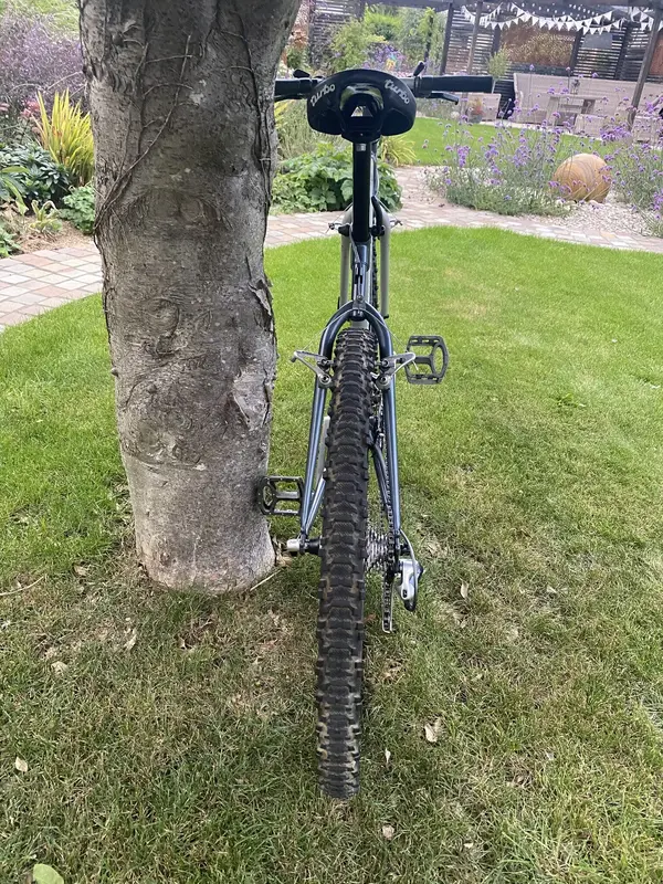

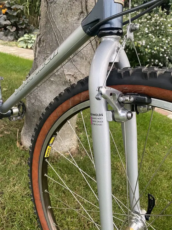

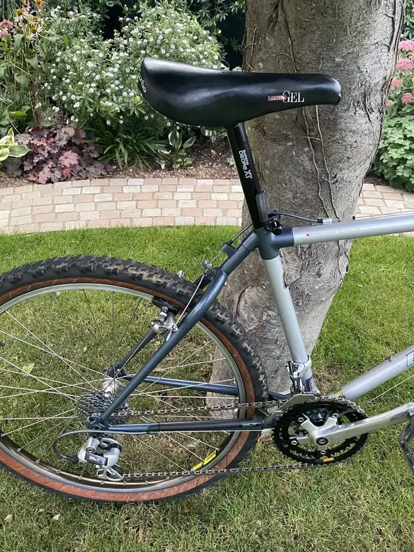

I’ve finished assembling with the bits I’ve got. It probably deserves some better condition parts, all serviceable but not minty which is a shame as the frame is really great condition. A couple of tiny marks on the head tube I’ve touched in but other than that it’s about perfect condition wise after a good polish. Needed one down tube decal as it had peeled but was a bargain from H Lloyd.
Wheels are temporarily m737/m738 hubs on bronze Mavic rims. They look ok but I’m almost there with finding the correct wheels. I’ve got the hubs, cassette and qrs as well as a complete front wheel of m730 hub on Araya RM-17 rim. Just need one more rim like in the photo above and I’m in business!
And the best bit, I managed to reuse all of my XTR cable spares again, needing one less outer than the last incarnation it did a whole bike this time! Think the grey suits this colour frame.
Light a bit crappy but just finished!

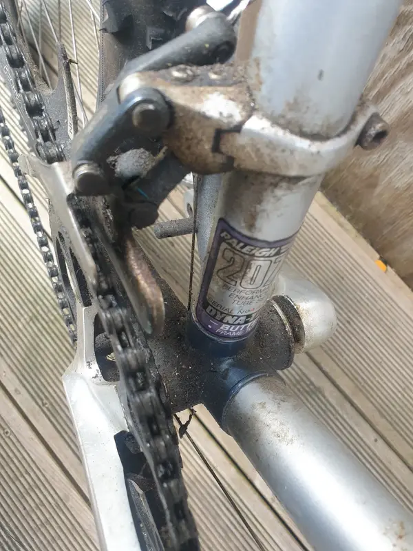

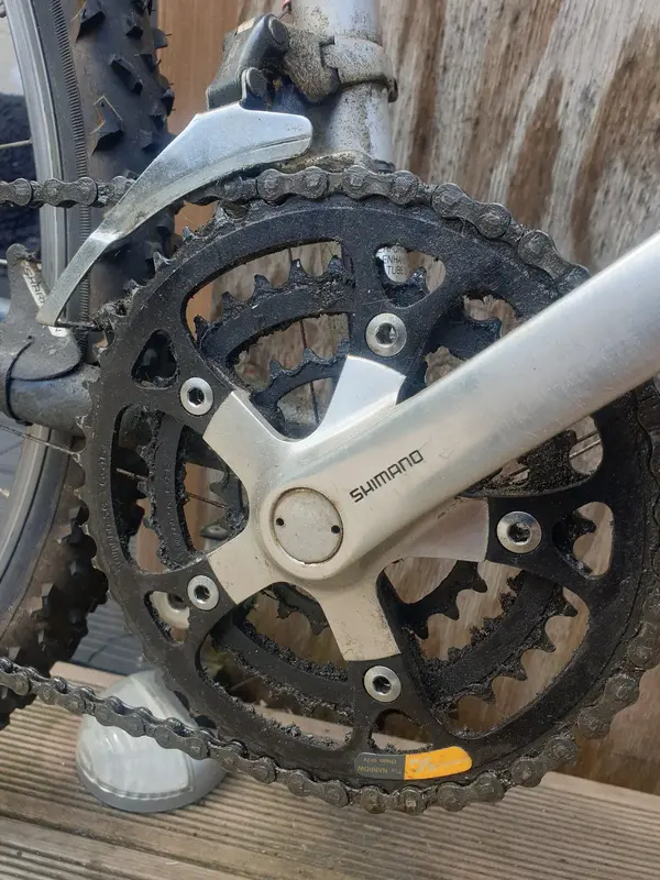

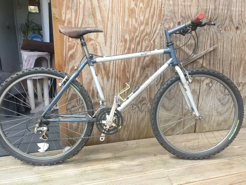

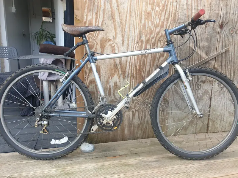

No not me, however I've just picked up an Odyssey just like yours, and Im itching to get started on restoring her back to her former glory
Heres how I got her...
