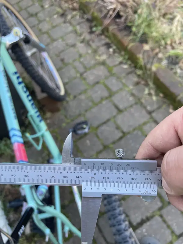

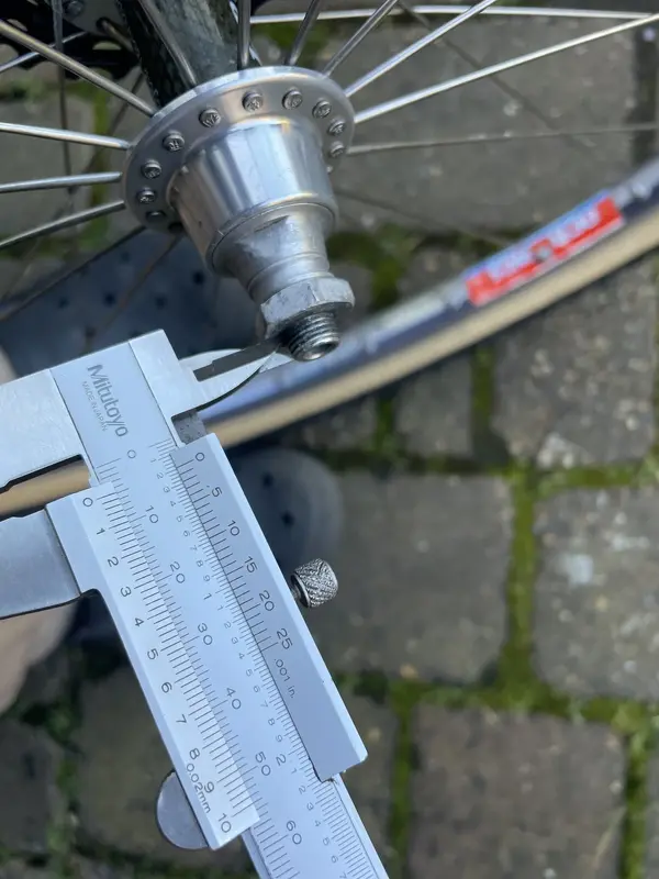

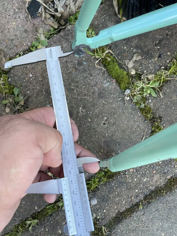

Well the hub axle measures 145mm across

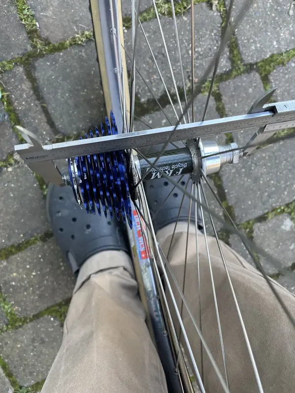

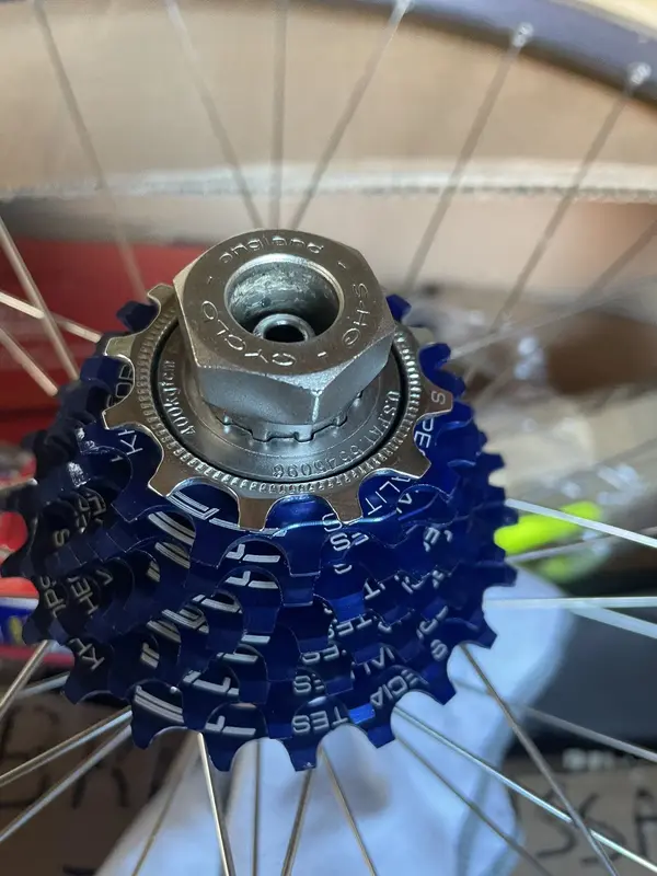

B54C50B7-7218-4E6F-8FBF-69A9E693F540.jpeg EC382DF7-7122-41FE-B6F9-CAF71F5BB713.jpeg The dropouts are
D7FE7956-26C4-4959-8F82-FBC6A95DFF96.jpeg E33C1008-FCF5-42D2-9043-D5A56B9F3852.jpeg
And the drive side is 6mm of thread
And off side 5mm

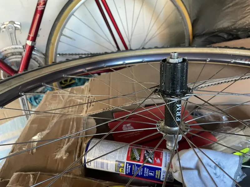

Problem is when I loosen the drive size locknut even by 1mm the axle develops play
May be an issue with the hub
1110ABB9-89F8-4543-8100-73B41DF9D1A7.jpeg BEB3E01E-4BC6-4F61-BCF1-1C596249CE55.jpeg
I guess a spacer behind the locknut of say 2mm and 1mm on off side could solve this ? Seeing as the drive side has 1mm extra

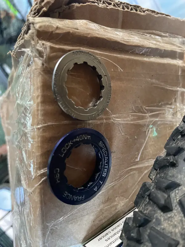

On the plus side the steel lockring is a full 1mm thinner
But on the minus side it’s too narrow to secure the smallest (silver) cog

Sorry to say this but you're measuring the axle [slightly] the wrong way. You need to measure the overlock nut dimension, i.e. outer distance between nuts. We can deduce this by taking 145 - 5 - 6mm = 134mm but maybe not quite as accurate as it's three measurements taken. That dimension really needs to be 135mm. Looks like you are 1mm out. Yes, a washer behind the nut should solve it.
On another note, the last position cog is a mile from the spokes... but I don't think/see there's a way to easily change that on your freehub (without grinding something).
