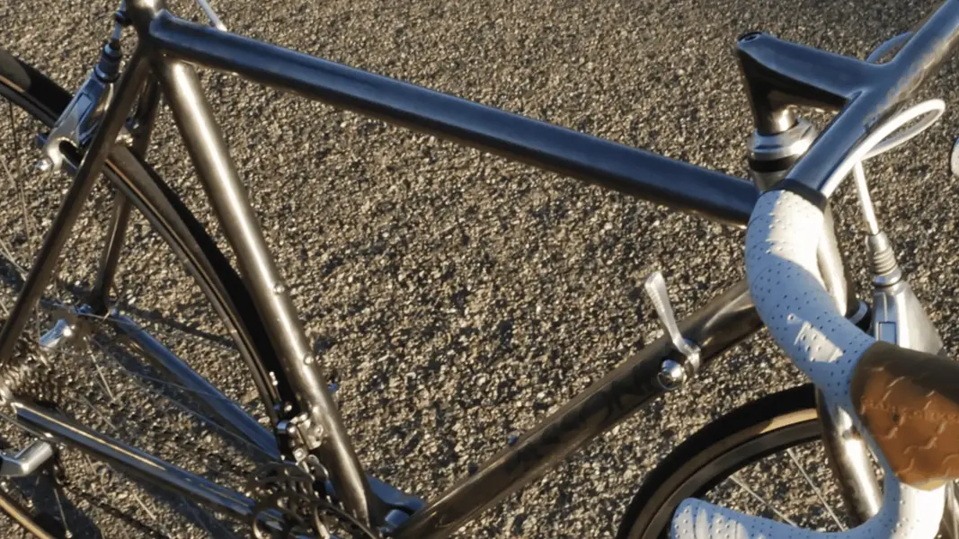

Got a Passoni Titanium frame, full polished… except a name sandblsating written on the top tube. I wanted to remove it.
a solution was gaved to me : some lapping paste for motor valve and rubbing with waxed canvas.
now, look the top tube
*faints*
