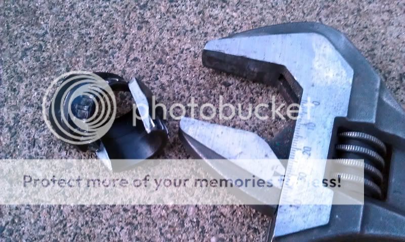

Another round to the bottom bracket! :x The Shimano remover simply could'nt take anymore :shock:

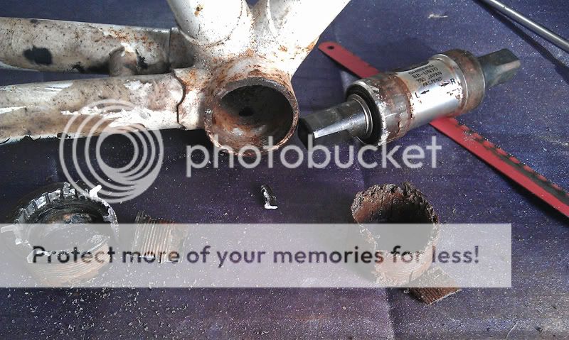

With this latest worrying development, i decided to punch the axle through the non drive side and try to cut out the drive side cup. I did'nt want to stress the frame or threads any further, and thought this was my only realistic chance of success....
:D Finally out! just like the seatpost, i could'nt believe how well the alloy had bonded to the steel!

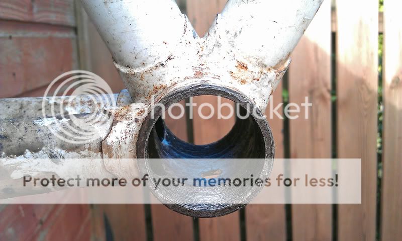

Thankfully, the threads are all intact, without damage, and the shell cleaned up really well :D
