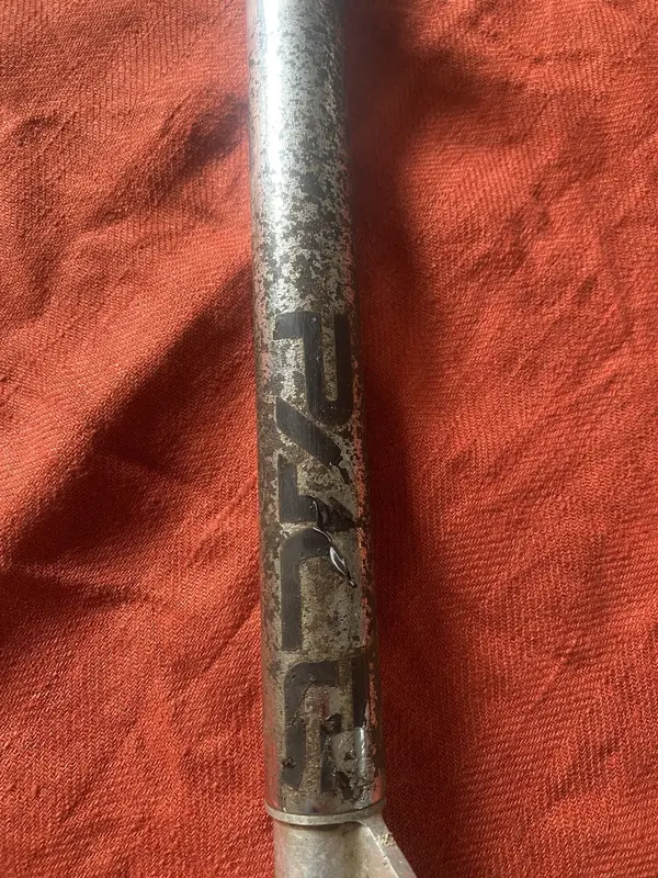

Yes I masked the aluminium dropout, the upper area that plugs into the crown and the brake boss pivot area, the finish depends on how bad the corrosion is and how many coats are applied. you need more and more coats to hide more corrosion. Can you post a picture of your fork legs?

I’ll do that. The pitting isn’t too bad and I’m sure a few coats with a bit of ribs down between should do it.

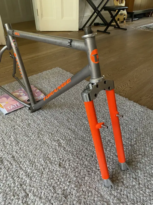

Inspired by your efforts here and a slightly ropey result with chrome paint I’ve gone Orange. But marmite but I think it looks great in the flesh…..
Looks good,like the bright colours
Are u adding decals on the fork legs to match the frame.
I got them off Gil @retrodecals
