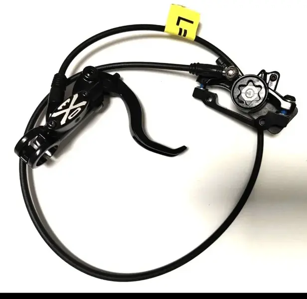

I have fitted new grips and front brake with rear Deore XT to be fitted.
Front brake is a bargain but not really inkeeping with high end parts fitted. Still has alot of power though and is brand new! Link here if anyone needs a cheap front brake.
