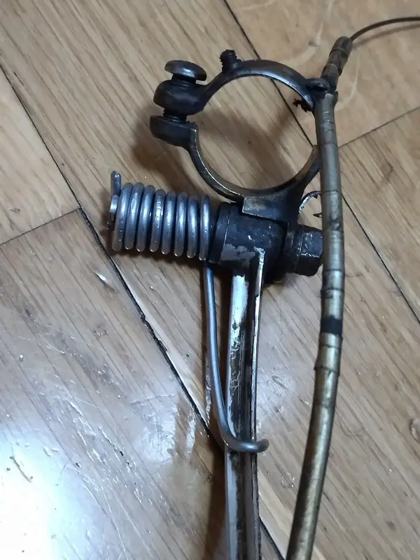

This example has, what appears to be, original cables outers. The wound wire sleeve is evident where the smooth coloured exterior has cracked and fallen off on the gear cable, but the brake cable is reasonably intact.

Here is an original coiled housing on an old Phillips brake, but im not sure of the age. It could be 30s to 50s.

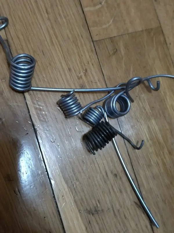

While waiting for the handlebar tape and cable housing to arrive I've build a coil myself for the front tension arm as the bike came without.
I've used 2.5 mm steel wire , pliers and a big bolt with a matching diametre to roll the coils around. It took me a few attempts to get the desired shape but I guess the end result will work as it produces a nice tension.
At the end I've just burned it in oil to remove this new & shinny look .

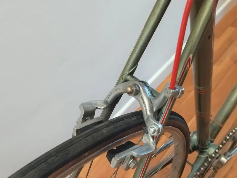

I've been thinking a lot on this and I've ended up with the easy option: modern red brake housing and cotton handlebar wrapping without shellack. The good thing is that both reds, housing and cotton handlebar tape, are really a match, not too bright. The maybe more period correct naked steel brake housing is just impossible to get (the VeloOrange one is pretty close though). I can always replace it in the future if I find something better, but I like how it shows up. It seems color housings were also an option in the 40's, either plastic or cotton braided ones....
For the shifting, I'm planning to go either with the same housing in red (yes, using the same 5 mm housing) or just remowing the plastic cover and leaving it naked. I've tryied in a small piece with a cutter removing the outer plastic cover and looks nice too. I bought a couple of red shift housing cables but colors were different ...
