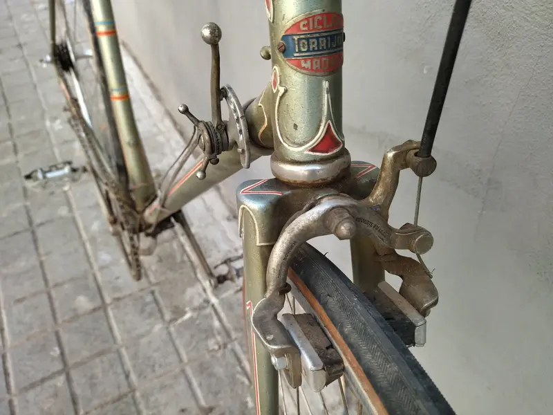

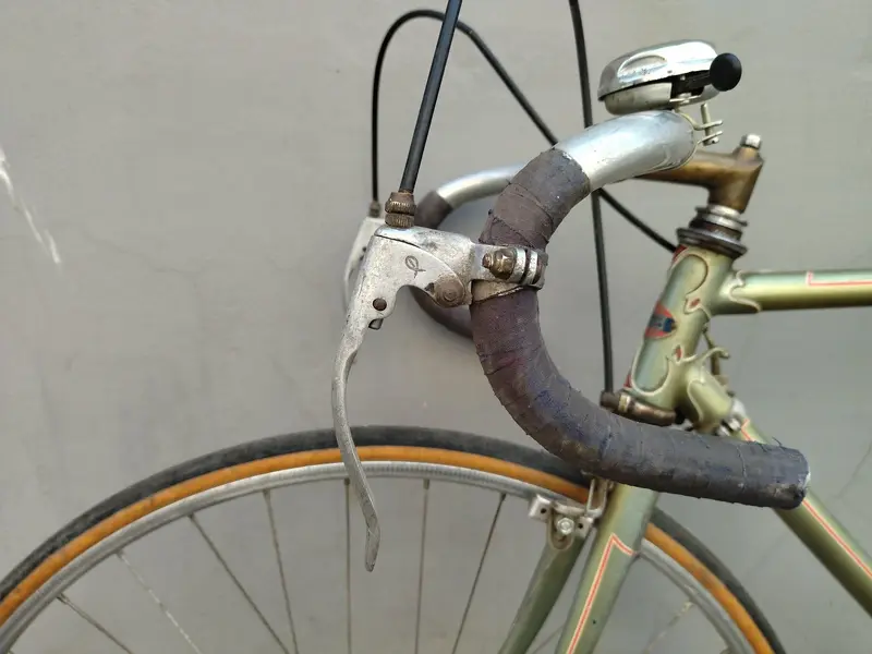

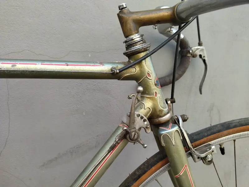

Now here it is my recent aquisition. From what I know it was a Spanish professional rider's bike and I would date it from 1936. It has Bowden brakes (did you know Bowden invented the internal cable & external housing braking transmission system used nowadays?), Super Riviera stem and a 3 speed Super Champion ("Osgear") Professionnel shifting system. Three speed indexed shifting , back in 1936!!!
Some pieces are missing and wheels need to be replaced but it's a nice restoration project ahead. This bike deserves it. Any information to help me about or any info on this period bikes will be much appreciated. I'll keep posting restoration progress!!

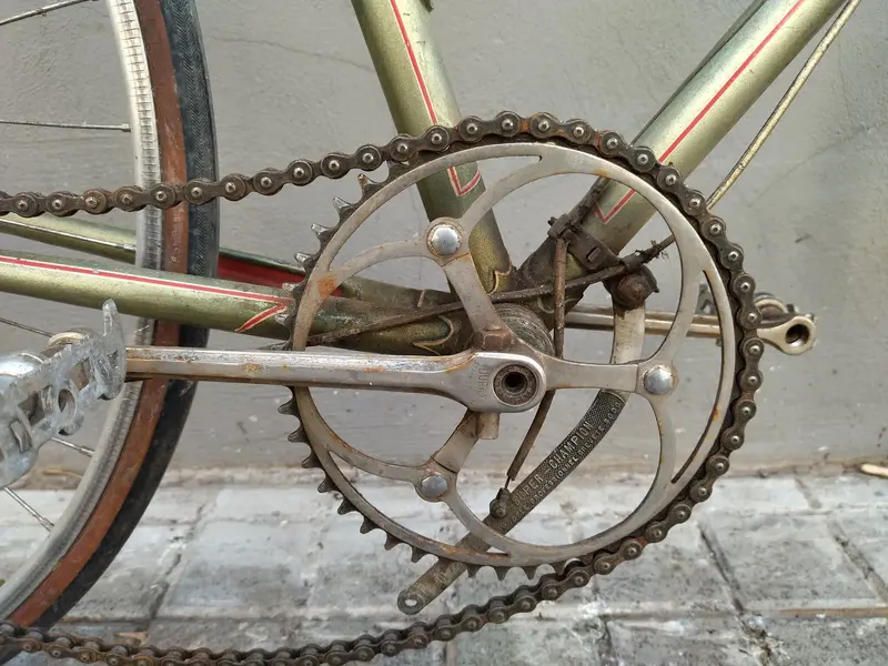

You have the Pro version Super Champion. Not indexed, with the very short movement of the cable you could run any gear in any of the holes on the lever. You also have the device for reducing the tension on the chain. If you want to use this just put an old gear roller in the tension arm, make something to keep the chain on, put the rear wheel in the forward location, then adjust the changing device as near to the cogs as you can and apply a little bending where necessary.
To change gear you would move the lever quickly well past the next gear position to flick the chain over then select whichever or any hole in the lever.
I used one of these 5 speed in 1950, and soon found the main problem. It is much better to feed the chain on to the cogs in line. In the late 30s it was a vast improvement on changing the rear wheel round.

Pro riders usually had the tension arm on a brazed on piece under the bottom bracket. I would have set the clipon arm you have as close to the lug as possible.

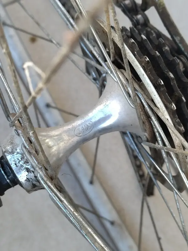

Coming to the wheels, not sure I'll go with wooden rims or alu ones; I believe both options should be ok and that will probably depend on what I will find around when time arrives. The thing is to replace current Zeus hubs (probably from the 80's)
